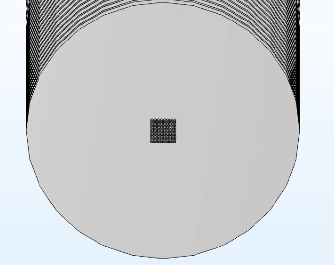

First of all, I am really appreciate to your answer.
I think explaining my situation must be really cooperative to your help so please let me explain it. I have perforated 17 by 17 holes in the middle of the electrode plate such as a following photo. However, is it possible to mirror field map or mesh map 5 by 5 part among 17 by 17? If not visualising, at least mirroring field and mesh map in code to export must be useful for my study, since I have to export entire mesh and field map to Garfield++ now in one file for each datum.
If you cannot understand my question or need more information for answer, please do not hesitate to let me know. Thank you.
First of all, I am really appreciate to your answer. I think explaining my situation must be really cooperative to your help so please let me explain it. I have perforated 17 by 17 holes in the middle of the electrode plate such as a following photo. However, is it possible to mirror field map or mesh map 5 by 5 part among 17 by 17? If not visualising, at least mirroring field and mesh map in code to export must be useful for my study, since I have to export entire mesh and field map to Garfield++ now in one file for each datum. If you cannot understand my question or need more information for answer, please do not hesitate to let me know. Thank you.
