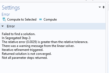

I am currently simulating my model using the Coil Geometry Analysis study in COMSOL. When I select the Single Conductor option for the coil, the analysis runs successfully.
However, I would like to proceed with a Time-Dependent study, which requires using the Homogenized Multiturn coil model. Since I have already modeled all the turns explicitly in the geometry, I set N = 1. But when I switch to the homogenized multiturn option and run the Coil Geometry Analysis, the solver returns the error “Failed to find a solution.”
Could you please suggest how to resolve this issue?

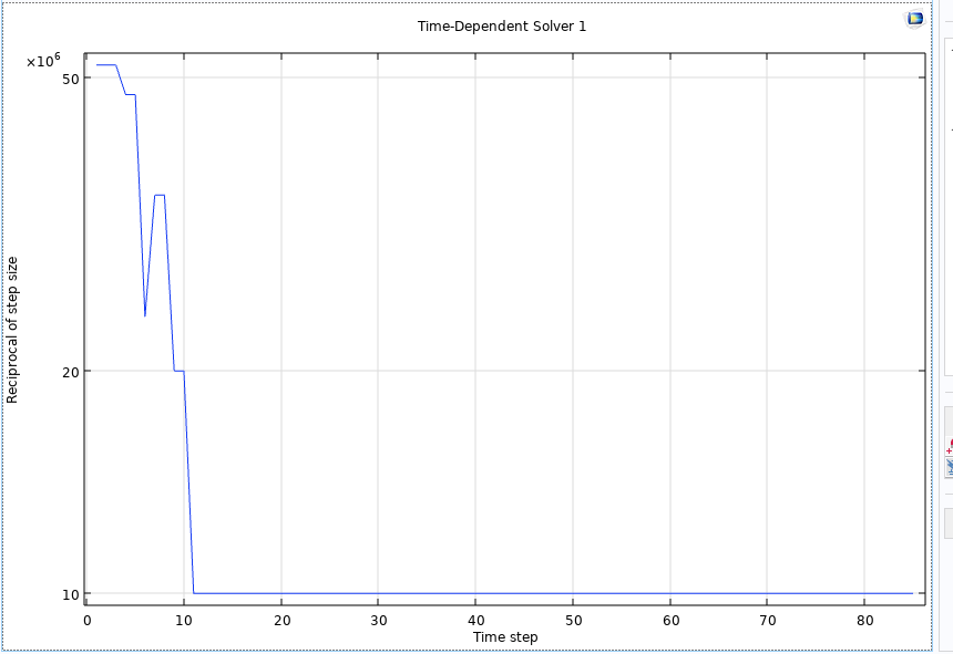

Even after using the Solid Conductor settings with a sinusoidal voltage excitation, the convergence plot is becoming constant instead of converging. I am unsure why the solver is behaving this way.

Anushka,
the solver is performing as expected. You set a strict time step of 1e-7 s and the time stepping converges to an inverse time step of 1e7 and remains there. That is how it is to be expected. Now let it run for the 5e-5 s you set.
Cheers Edgar
