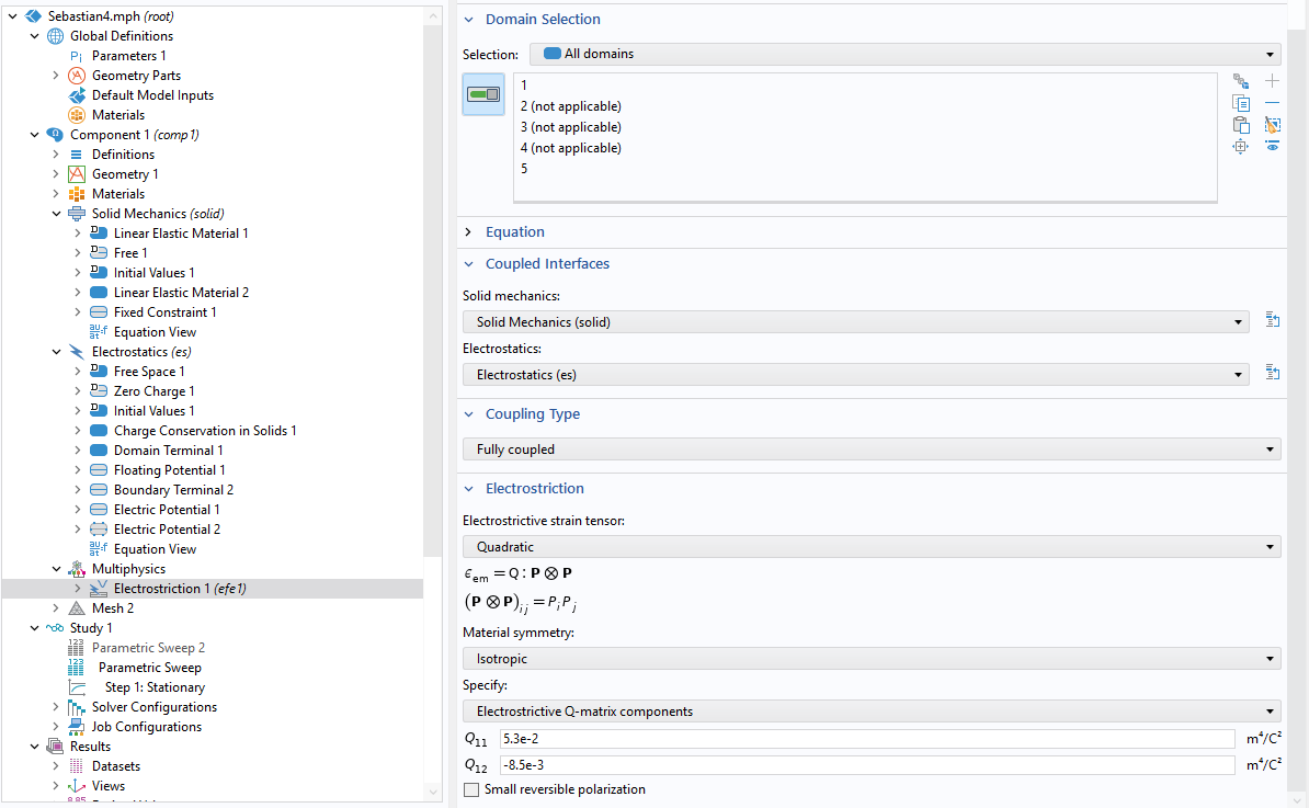

I have another question regarding the electrostriction effect: how can I add this effect? I used the coupling for electrostriction and added the Q electrostriction tensor, is this enough? It seems to me that I am missing something.
I am sending a printscreen of the physics I am aplying to my model, as the geometry of my problem too.

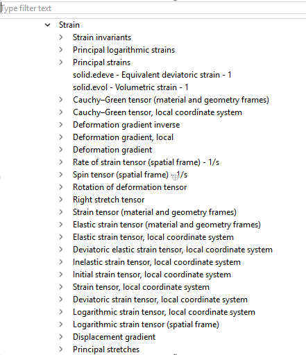

I am not certain that I fully understand your question. There are many types of strain results available in the result menus, including strain components in local directions, and the principal strains. See the attached screenshot.
Henrik Sönnerlind
COMSOL
