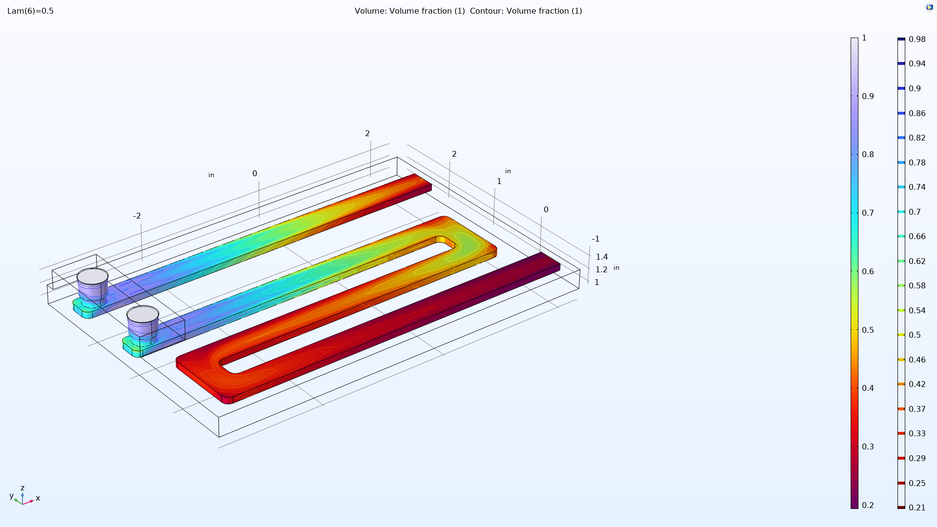

I am trying to adapt the extended RPI flow boiling model to my own expiramental setup where i have liquid nitrogen flowing through two channels in a metal test piece, with known heat flux applied to the bottom side. I have replicated the exact setup as the published application. The convergence has failed consistently. I have tried auxillary sweep on the boiling and heat flux, running fully coupled and segregated studies, putting a solver limit on the volume fraction, to no result.
This is how it has been failing:
Undefined value found. - Detail: Undefined value found in the stiffness matrix. There are 111 equations giving NaN/Inf in the matrix rows for the variable comp1.T. at coordinates: (0.0369032,0.029986,0.0268232), (0.0377371,0.0311923,0.026833), (0.0370727,0.0323953,0.0268382), (0.0348952,0.0336535,0.0268406), (0.0341695,0.0347622,0.0268414), ...
and similarly for the degrees of freedom, NaN/Inf in the matrix columns.
here is the application, and screenshots of my own model in an experiment that converged using water, as a reference: https://www.comsol.com/model/subcooled-nucleate-boiling-with-extended-rpi-model-113081
