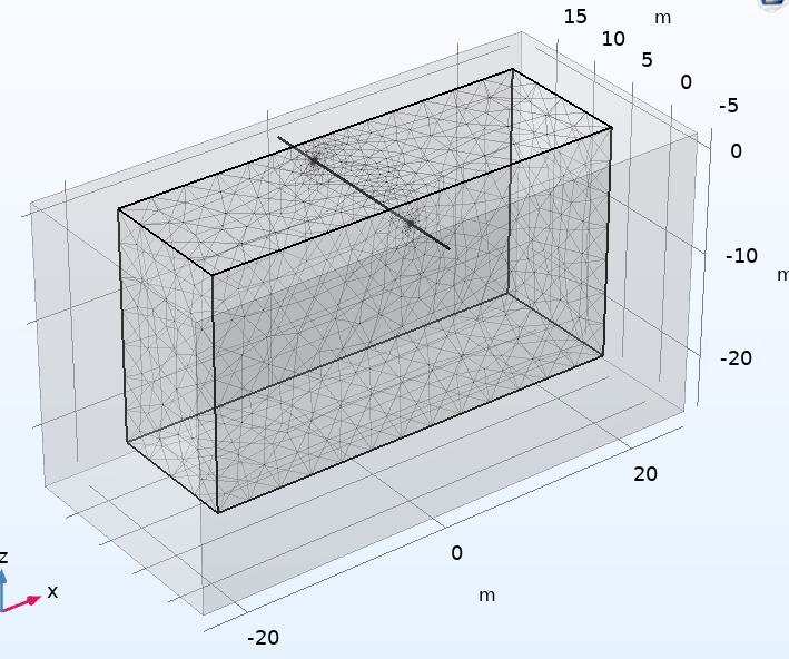

I am modeling heat transfer from an underground cable using Heat Transfer in Solids. The cable is within in a finite hexahedral soil domain, with an outer soil region assigned as an Infinite Element Domain.
The top surface represents the physical ground surface and uses a Convective Heat Flux boundary condition. Therefore, I do not want the infinite-element region to extend upward.
I understand that a Cartesian infinite-element region should be divided into separate face, edge, and corner domains rather than treated as one hollow hexahedral domain. I am currently modifying the geometry accordingly.
I also understand that the infinite-element domains should preferably use a swept mesh. With my current geometry, physics-controlled meshing has difficulties because the top is open and some regions do not appear to have clear parallel source and destination faces. A free tetrahedral mesh could be generated, but the study then failed because COMSOL could not identify valid Cartesian regions in the infinite outer domain.

I have attached images of my current geometry (and the figures I have referred from your Learning Center post).
