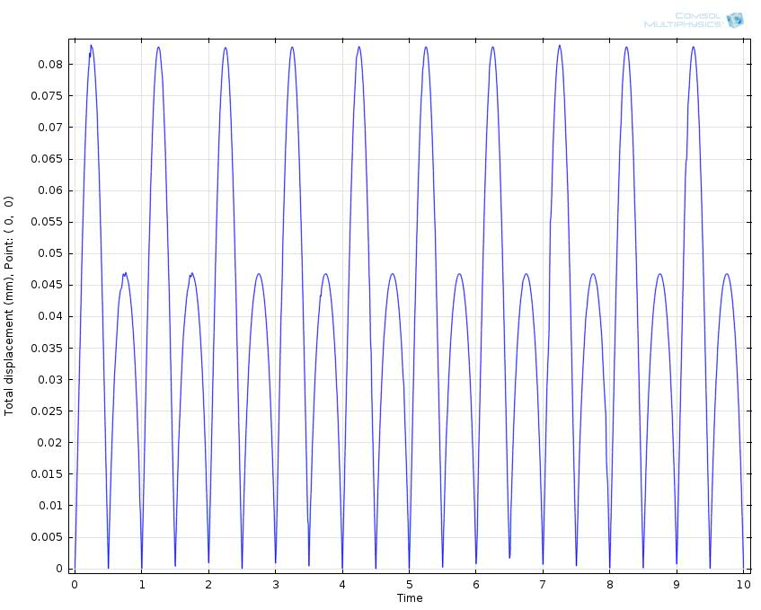

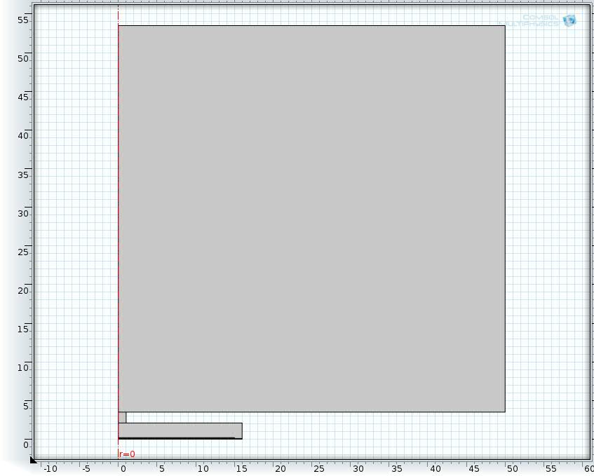

I am working on simulation of synthetic jet actuator and i am coupling the FSI and Piezoelectric devices physics. i am trying to model case study from one of the paper that was presented in comsol conference 2010 in order to develop my confidence with Comsol because i am new comsol user here is its link
www.comsol.com/papers/9465/

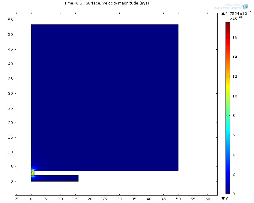

the boundary conditions are 2D Axisymmetric and applied voltage is 100 and also i have a reasonable deflection of diaphragm like 80 microns but the exit velocity is too low the order of 10^-20 etc, i think that their is coupling problem between Piezoelectric and FSI. Please tell me that do i mention some coupling command between these two physics

i have attached geometry and some result i need your help
