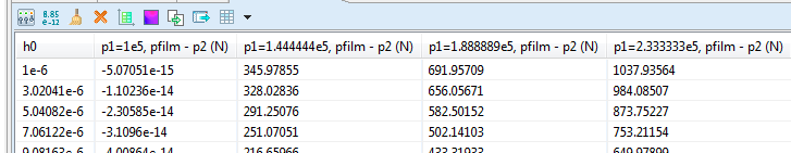

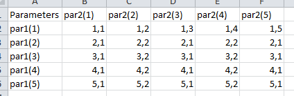

What I would like to happen is that the parameter values would show up in the first colum and the first row of the table. Currently I am only getting the first column right. All the values of par1 are listed on each row. But the problem is with the first row and the headers. It currenty gets generated as par1=<value>, <desc> on each column. This makes it difficult to use in Matlab since I would have to parse the useless data out every time just to use the value.
I have attached images of what is happening and what I would like to happen.
