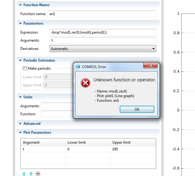

Ok, so I defined the parameters, Amp and period1 in the parameters menu. When I try to plot the an1, it gives me an error "unknown function or operator" mod1.rect1.
I attached a picture of the error if you want to take a look.

Hope that it will work now.
