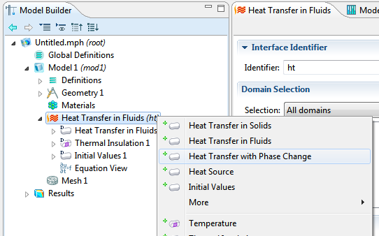

Dinesh,
What version are you running?
New in Version 4.3b you can add "Heat Transfer with Phase Change" as a domain physics condition to Heat Transfer analyses.
See attached screenshot from v4.3b.
Josh Thomas
AltaSim Technologies
Dinesh, What version are you running? New in Version 4.3b you can add "Heat Transfer with Phase Change" as a domain physics condition to Heat Transfer analyses. See attached screenshot from v4.3b. Regards, Josh Thomas AltaSim Technologies

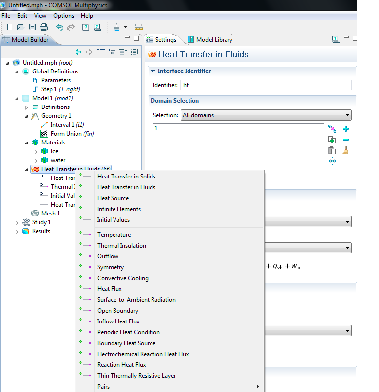

Sir
i am running 4.2a and 4.3 but both of these version dont have that option as i showed in the screenshot. Is it bcoz of version only. How can i add (phase change) in my version
[QUOTE] Dinesh, What version are you running? New in Version 4.3b you can add "Heat Transfer with Phase Change" as a domain physics condition to Heat Transfer analyses. See attached screenshot from v4.3b. Regards, Josh Thomas AltaSim Technologies [/QUOTE] Sir i am running 4.2a and 4.3 but both of these version dont have that option as i showed in the screenshot. Is it bcoz of version only. How can i add (phase change) in my version

Hello Dinesh
"Heat Transfer with Phase Change" is a feature that is unique to the Heat Transfer Module (see www.comsol.com/products/specifications/heat-transfer/), so your screenshot suggests that you do not currently have that Module. You can check which Modules your license carries by going to the Options > Licenses menu.
Hello Dinesh "Heat Transfer with Phase Change" is a feature that is unique to the Heat Transfer Module (see http://www.comsol.com/products/specifications/heat-transfer/), so your screenshot suggests that you do not currently have that Module. You can check which Modules your license carries by going to the Options > Licenses menu. Best, Jeff
