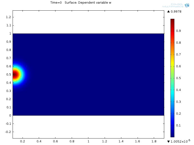

At time = 0 ns, I get a nice round blob, as expected
(see file "2D_ConvDiff_ExtrFineMesh_Circle_h0_2mm_0ns.jpg")

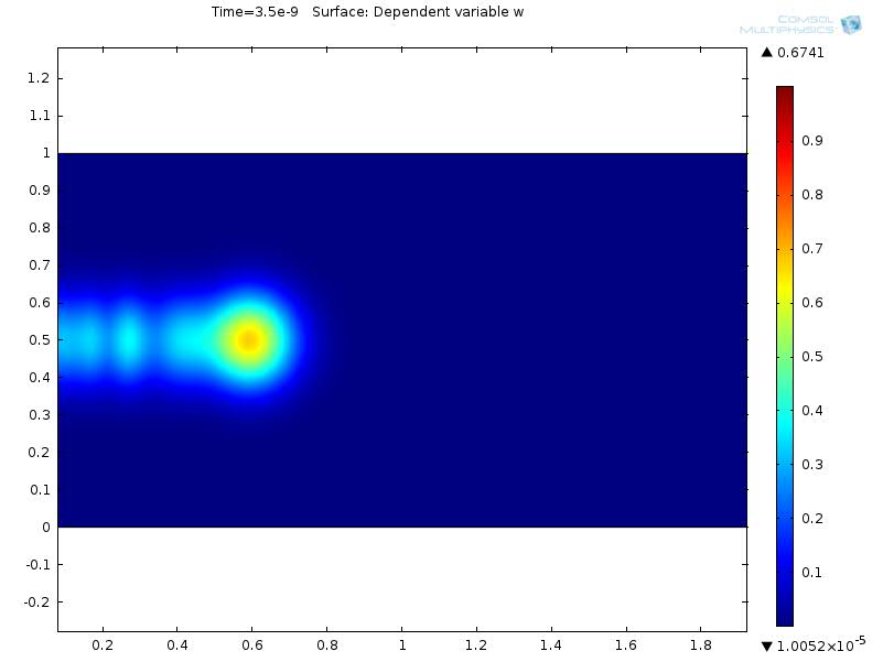

At time > 0 ns (for instance 3.5 ns and 7 ns), this blob moves to the right, slightly diffused in all directions
However, there seems to be a strange ripple in the tail after the blob...
(see file "2D_ConvDiff_ExtrFineMesh_Circle_h0_2mm_3p5ns.jpg")
So, my question is: why do I get these ripples?

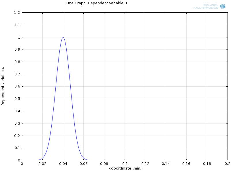

The initial density "u" I set to a Gaussian shape:
u = exp(-(x-DelX)^2/radius^2),
where DelX = 0.04 mm (to make sure the Gauss is well within the bounds of the line) and radius = 0.01 mm.
Now, I get a result similar to case 1) (however, now I have diffusion set to 0).
At time = 0 ns, I get a nice Gaussian shape
(see file "1D_DriftOnly_ExtrFineMesh_h0_0p2mm_0ns.jpg")

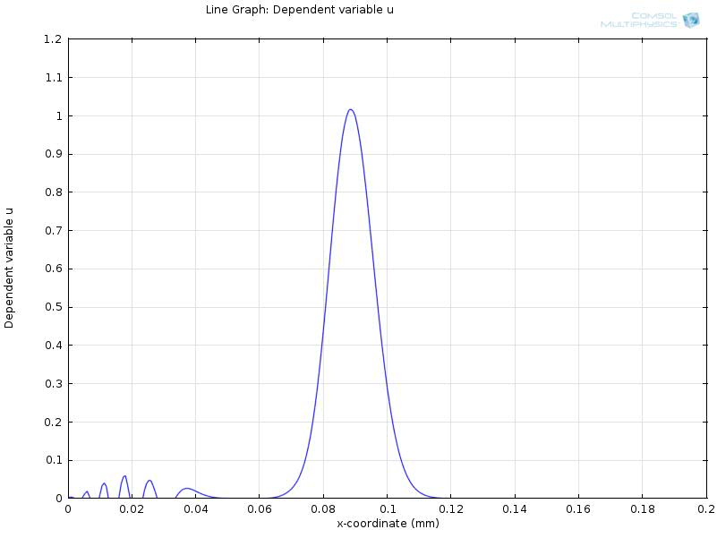

At time > 0 ns (for instance 3.5 ns and 7 ns), the curve moves to the right.
However, again, there appear strange ripples after the tail of the curve
(see file "1D_DriftOnly_ExtrFineMesh_h0_0p2mm_3p5ns.jpg")
So, my question is: why do I get these ripples again?

It is not surprising that you have oscillations because your problem has a very high Peclet number and in fact with diffusion set to zero it is purely a hyperbolic equation best solved via lagrangian or particle based or any suitable methods. What you experience is a well-known numerical issue and have been addressed extensively in literatures (e.g. cece.ucf.edu/people/yeh/briefcv/index.asp).
Within COMSOL itself you could find schemes to minimise problems with high Peclet numbers. For example, you can use their transport in dilute species module which offers consistent and inconsistent stabilization (if you don't have this module, you can also find the provision in heat transfer module or laminar flow module). They also give an example of a 2D heat transfer solution with high Peclet number. Of course, you must be aware that use of such schemes would result in artificial dispersion. If you don't have any, then you are stuck with putting an artificial diffusion yourself as you have done and ignore the oscillations if it is not that critical.
Alternatively, you could try adaptive meshing or particle tracing module (considering that yours is purely advective) in COMSOL.
