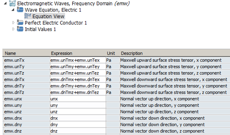

Posted: 1 decade ago 16 juin 2014, 07:53 UTC+2
Hi,Sergei,your reply helps me a lot.
I have a question, what the difference between the emw.unTx and the emw.dnTx? How could I choose it?
And where can I find the information about the expression "emw.unTx", I can't find it in the comsol help document.
Thank you!
Best regards
Hi,Sergei,your reply helps me a lot. I have a question, what the difference between the emw.unTx and the emw.dnTx? How could I choose it? And where can I find the information about the expression "emw.unTx", I can't find it in the comsol help document. Thank you! Best regards
Posted: 1 decade ago 16 juin 2014, 17:19 UTC+2
Zerong,
Variable emw.unTx corresponds to Maxwell upward surface stress tensor and is calculated using normal vector up direction emw.unx.
Variable emw.dnTx corresponds to Maxwell downward surface stress tensor and is calculated using normal vector down direction emw.dnx.
These variables are defined under Equation view, as shown in the attached image. To visualize the directions of the normal vector up or down, create line plot of the corresponding vector components
For particle surrounded by air, use upward surface stress tensor components to calculate force on the particle.
If you want to calculate force on the air interface, use downward stress tensor.
Sergei
