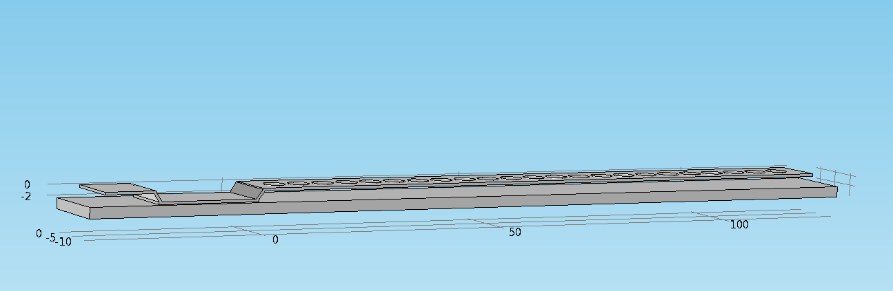

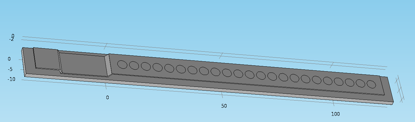

i am trying to simulate the structure something like attached figure. what i need to do is apply sinusoidal excitation (of resonant frequency of whole structure ) at the base (lower layer) of the structure..and see the deflection of free end of cantilever beam..which i m sensing by reflected light, from the structure..laser light is incident upon this end from the top..
my doubts are how do i apply sinusoidal excitation at the lower layer ie base.??

you didn't tell us, which application mode you are using and what the frequency range is. In general you can apply a potential, port, or terminal BC to the plate and then run a frequency domain study in the frequency range of interest.

sir i have to give the excitation frequency as resonant frequency of the structure..that i need to find out from eigen frequency analysis and i am applying sinusoidal voltage of same frequency with a potential in pzd module through piezoelectric material of same size as base, placed below to it..i m getting error like last time is not converged..what i can do ??? and also how to add viscous characteristics of surrounding air.??
