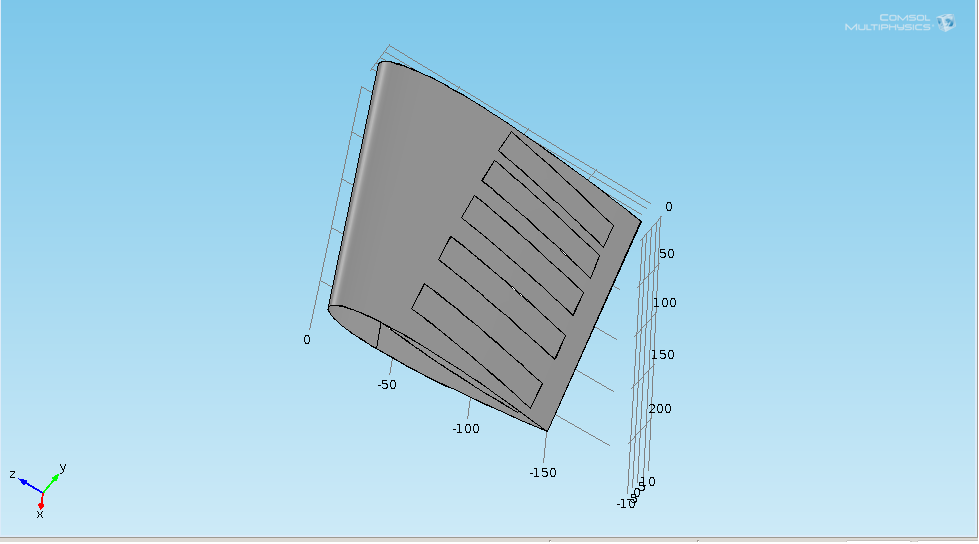

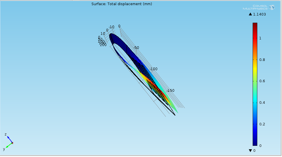

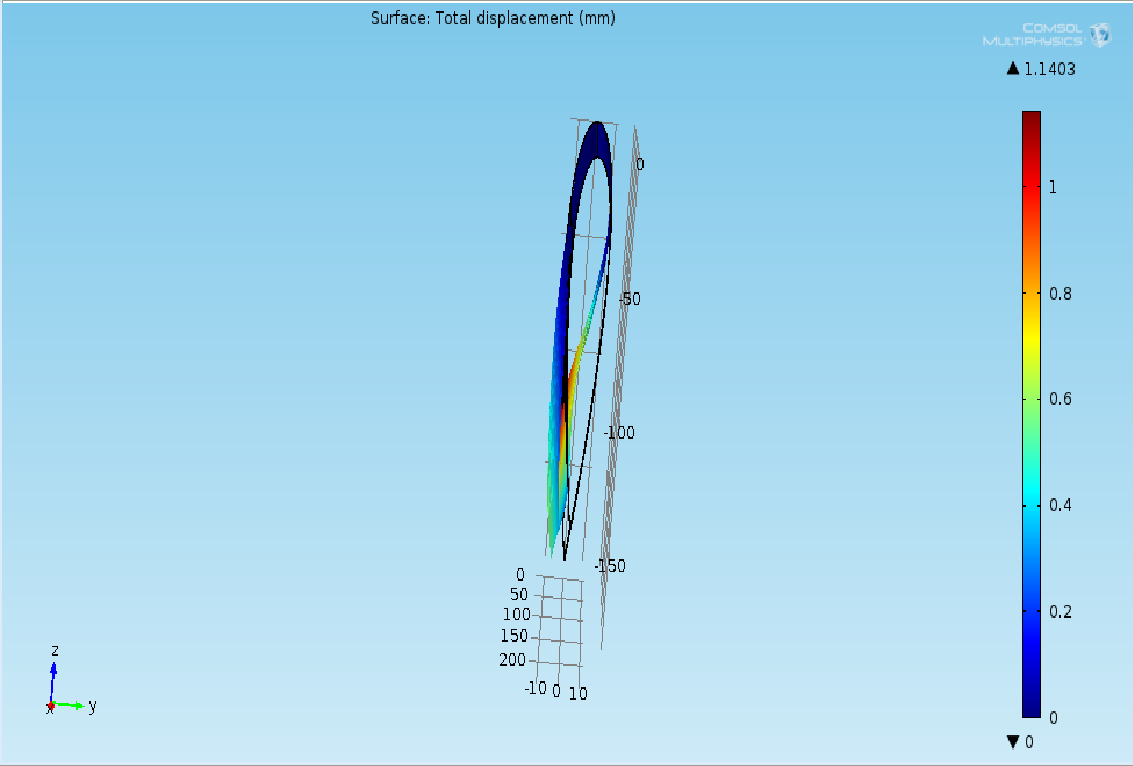

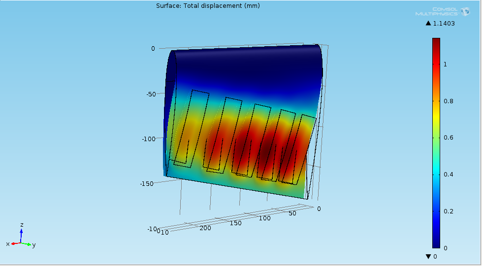

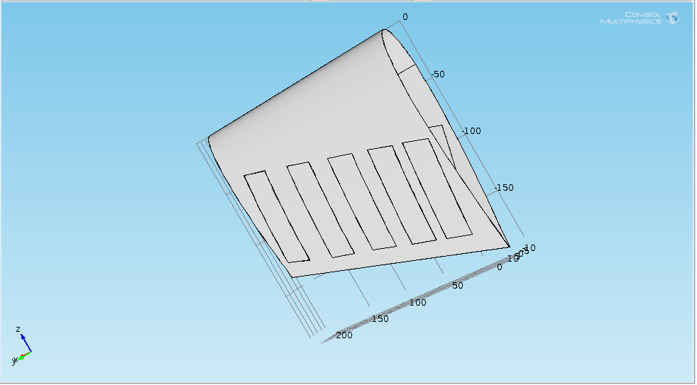

Dear ALL,
I have a question,i have results from one physics(deformed geometry) and i want to use it for further analysis in other physics.is there any way to do it.
i have attached my deformed and un-deformed geometry pics.
please let me know if it can be done in any way.
