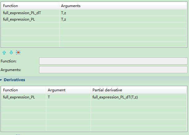

I am using COMSOL matlab function, and I defined two functions: full_expression_PL(T,z), full_expression_PL_dT(T,z), where full_expression_PL_dT is the derivative respect to T of full_expression_PL. I clicked the Plot, the two functions can be showed successfully. However, when I compute the model, here comes an error:
Error in user-defined function.
- Function: dfull_expression_PL_dT
- Expression: d(d((2*test(mod1.Te)*mod1.Irzt*full_expression_PL(mod1.Te,z)*pi*r)*(dvol),{test@0}),mod1.Te)
The attached file is the Screenshot of the matlab function definition window.
Is there anything wrong in the definition? Does anyone know why this happens?
Thanks!

Its hard to give advise without seeing your m-files.
My guess is that dfull_expression_PL_dT has an error. Have you tried to call it with arguments consisting of column vectors (with suitable values).
Also from the error message it seems as if you also need the second derivative.
