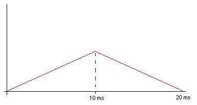

I'm trying to build a periodical wave. I want it to be linear, with its first semiperiod as an ascendent linear function, and the second semiperiod as a descendent linear function. Just like in the attached image.

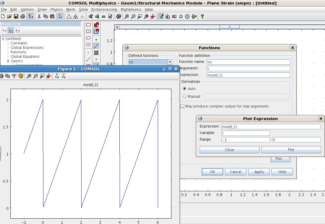

but you will not really get a "linear function" with the heaviside smooth step functions, however it will be derivable.
When I have a problem with a mathematical function in COMSOL, my way around is to plot it as a "function" see below
Hi but you will not really get a "linear function" with the heaviside smooth step functions, however it will be derivable. When I have a problem with a mathematical function in COMSOL, my way around is to plot it as a "function" see below Good luck Ivar

I've been working on creating this wave, and i ve decided to define it this way:
(t*H0)*(t<0.01)+((0.02-t)*H0)*(t>0.01)
I've realised that what i was trying to do at the beginning was a bit complex. The result is on the attached image. I only need one period of this wave. If i need the wave to be periodic in time, i'll have problems, because this description is not ok, the resultant wave is permanently decreasing from t=0.01. I'll investigate more.

indeed it would most probabay work, if not try to step in a concetrated way at your slope changes. You still have the modulo to make it periodic.
If you still have convergence problems, you could fit a smoother sin function just around your slope change. I mostly use Maple to help me formulate my math for such piecewise continuous functions
Hi indeed it would most probabay work, if not try to step in a concetrated way at your slope changes. You still have the modulo to make it periodic. If you still have convergence problems, you could fit a smoother sin function just around your slope change. I mostly use Maple to help me formulate my math for such piecewise continuous functions Good luck Ivar

normally t is expressed by default in seconds, so I would use a "t[1/day]" (this works in v4, probably also in 3.5) in your call
Define a function with your expression, that helps to test it, as you can plot it out
and you should check your balance of "()"
