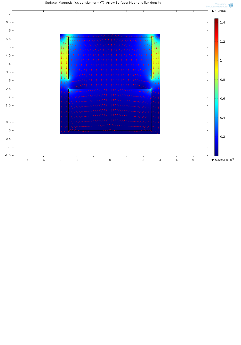

hello, i want to make a permanent magnet, and see the magnetic flux density norm using arrow surface. i found a picture of a magnet, see attached photo, but i need to know how i can make this, because i need similar magnets for another project. i've been trying different methods but so far it has been unsuccessful. please can someone help me.?

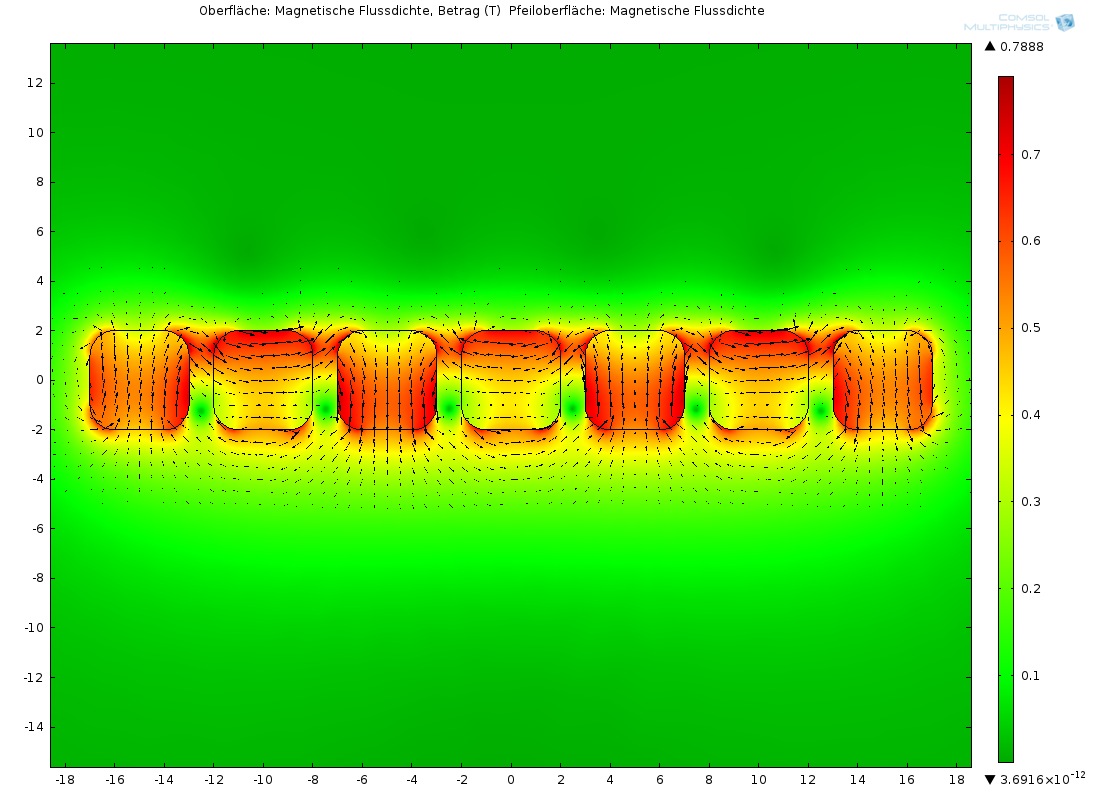

I have attached the image below, I assigned remenant flux in accordance to ur instructions.
And let me know last few queries, these might be basic but new for me, so plz let me know that is there something like geometry dependency like I should Flux for circular or curved shape geometries and for straight or rectangular parts, I should use AIR medium and what should be the value of Tesla?
