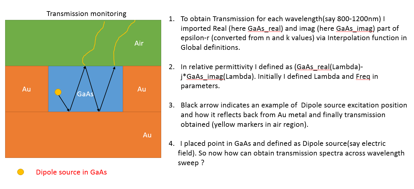

(I had attached the concept of my simulation as picture where you can understand my idea)
My Goal is to get PL spectra (may be Transmission ) vs wavelength. I had placed Point in GaAs and used that as Dipole source. My target is to achieve Transmission spectra coming out from GaAs vs wavelength (say 800-1200nm). I m really confused here how-to-do. For obtaining transmission spectra do I need to use port condition or what ?

First of all thanks for your model and try. Its really helpful since I m just beginner in COMSOL. I had attached the geometry of my structure . Previously i used Scattering BC, but now changed to PML as per your ex.
For obtaining transmission(hereafter T or PL) spectra, i think we can adjust the height of transmission monitor to get the best from GaAs top surface.

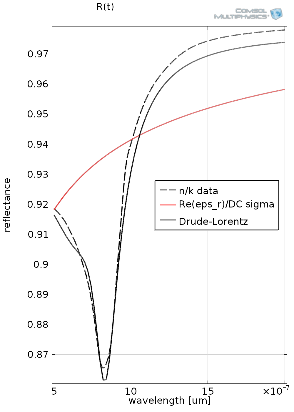

I'd like to address first that you have n/k data, but you keep reverting to permittivity. I would not suggest this. I have looked extensively into the different "Electric displacement field" models, and it will generally be best to use n/k data and solve for index if you have good n/k data on your materials. Look at the equations for "refractive index": eps_r = (n-ik)^2, and sigma = 0. The loss is accounted for in the k term, so it is permissive for sigma to be zero. But when solving for "relative permittivity", defining eps_r = (n-ik)^2 in your material properties and setting sigma = 0 is the SAME MODEL as the index model. It appears that the best use for the perimittivity model is when the eps_r term is expected to be a real component, and the sigma term is expected to be the DC conductivity, and the material loss is encompassed in this conductivity term. Now, either eps_r or sigma MAY be complex, such as utilizing an optical conductivity, but if both term are complex, it seems from the equations that the loss would be double counted--this was confirmed by a COMSOL tech.
From a test of several different displacement field models, I have found that for gold or aluminum in the optical regime, the only way to accurately match n/k data is to use the Drude-Lorentz model (out to five oscillators), defining eps_infinity as 1-(f0*omega_p^2)/((2*pi*freq)^2-i*(gamma_p*2*pi*freq)), with f0 the high frequency oscillator strength, and omega_p and gamma_p the plasma and damping frequencies, respectively. I've attached a graph of using three different models and measuring the well-known reflection of aluminum in the optical regime. The n/k and Drude-Lorentz models match well, but the relative permittivity model, using a real eps_r and a DC sigma, do not, because it does not account for the optical transitions. I will upload the model so you can play around with different methods, too.
For your other questions, I think I will post to your other discussion, as this would be getting off the original subject.
