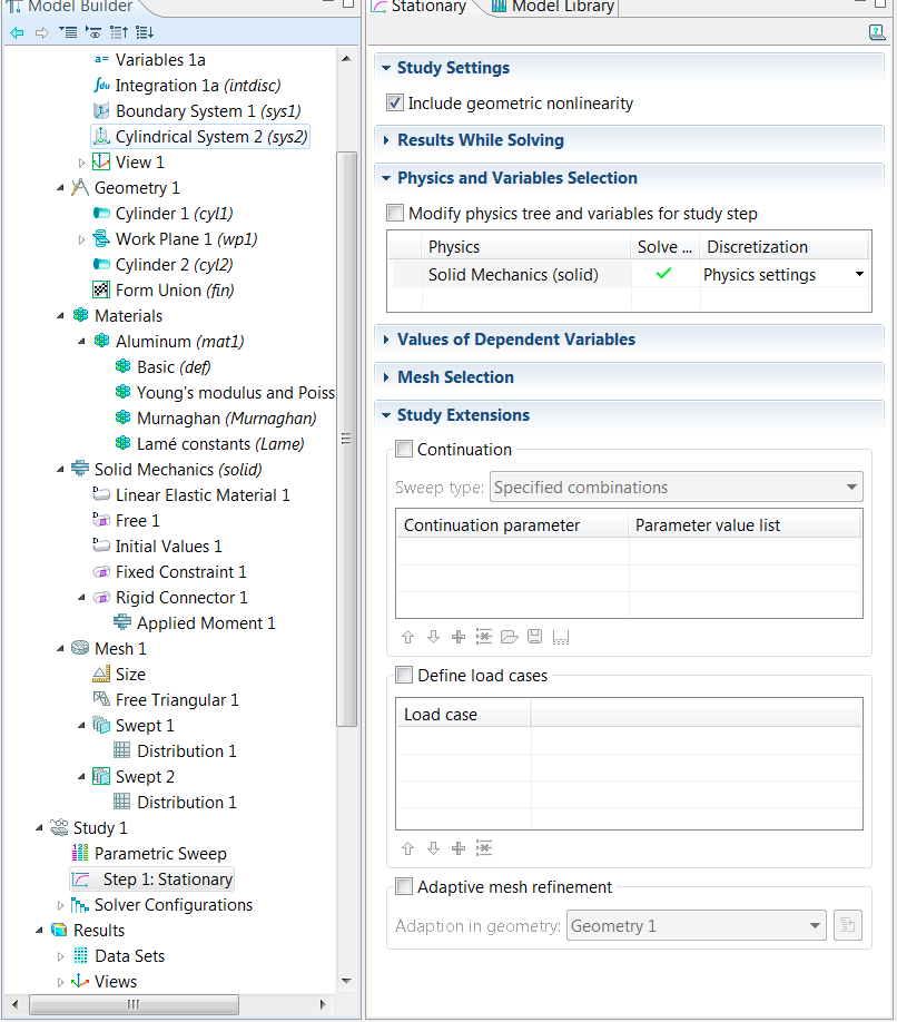

With the boundary setting "Rigid Connector" you can directly give a moment to a surface.
Look at the model attached!
Remark:
"Include geometric nonlinearity" (Large_Deformation.PNG) introduces the calculation for large deformation.
You find information in the HELP about this topic. HELP >> Documentation >> Structural Mechanics Module >> User's Guide (PDF) >> Search for "Include geometric nonlinearity" or "large deformation".
Make some tests, new models and come back to us if you have additional questions >> support@comsol.com

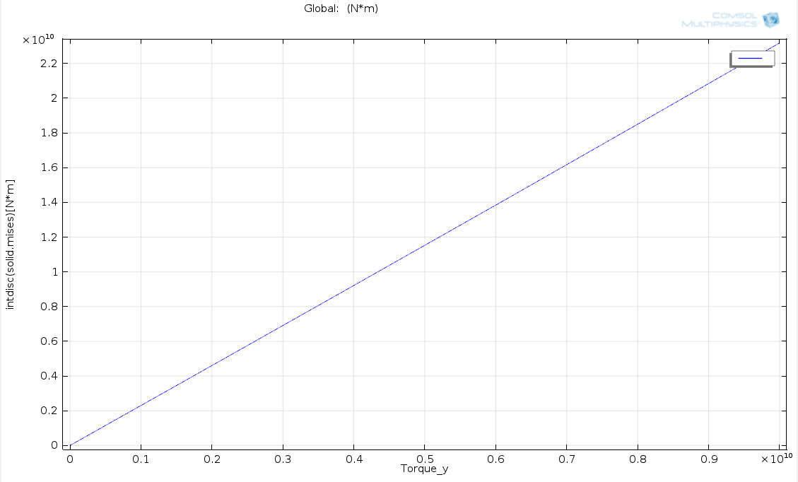

Where I'm still having problems is that I want to plot/evaluate the torque that is applied to the disc.
I simply want to plot the torque applied to the disc as a function of the torque that I programmed the simulation to apply. I should therefore have a linear graphe with a gradiant of 1.
I have tried to do this with what I think is the applied torque on the disc, I have a linear graph but the gradiant isn't 1 (see attached file).
Could you show/tell me how to do this?
Thanks again!
James
