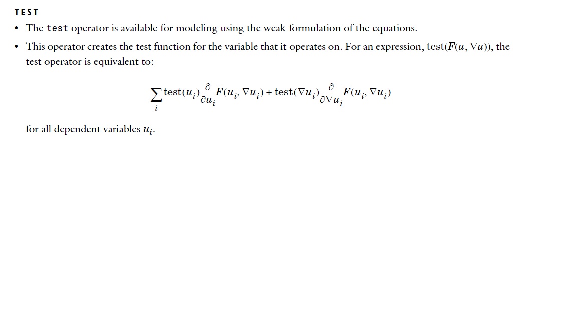

In the attached image is the answer for the test function. hope helps
