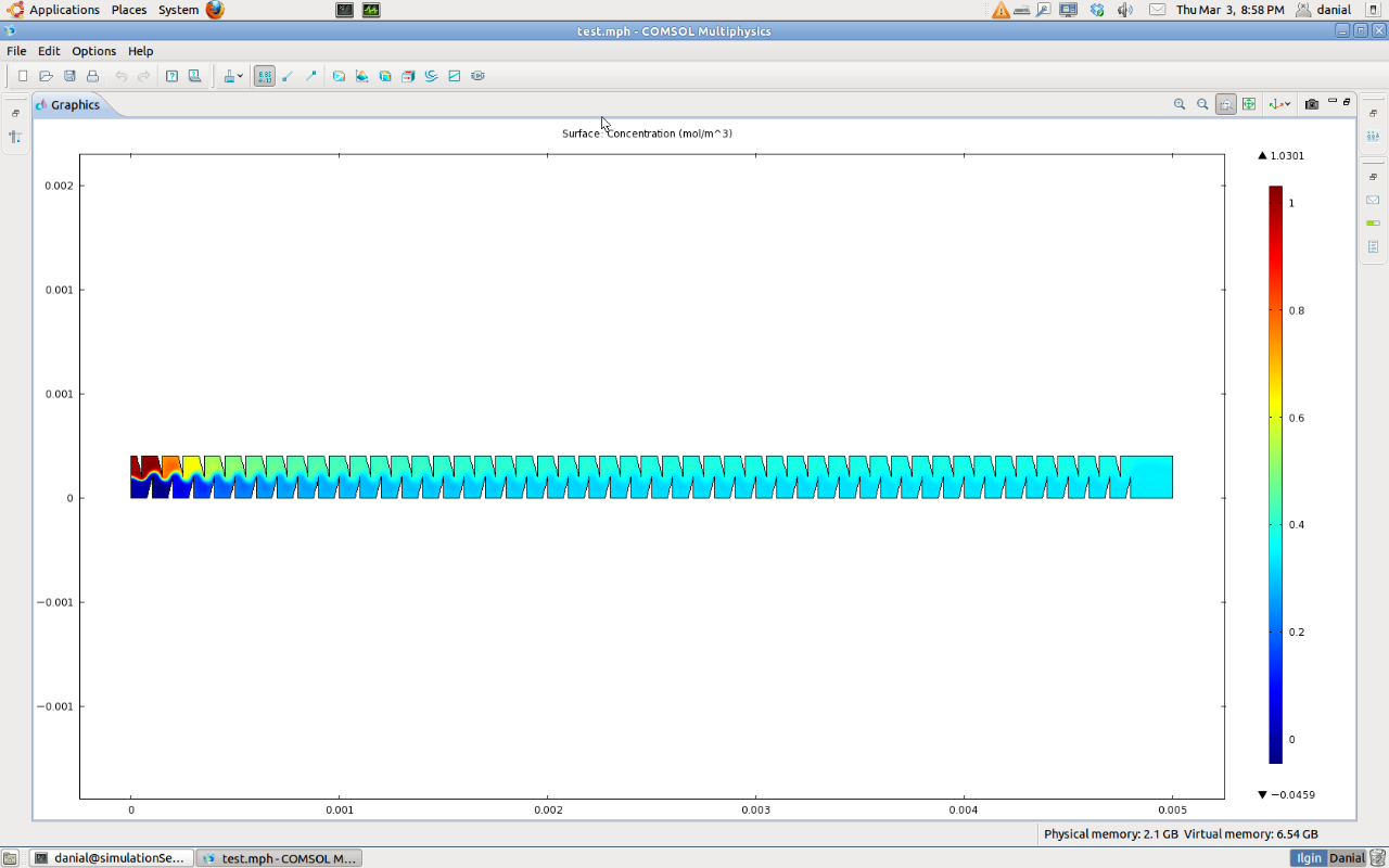

I redid your model in Comsol 4.1, since I am more comfortable with that.
- Your inlet concentration is based on hight, y, which if you look starts from -1e-4 to 1e-4, so you have actually a negative inlet concentration which messes up everything.
This is the model result I got. Of course there are some oscilaltions int he result (higher concentration than 1), but with mesh refining you can avoid it as much as possible.
Comsol 4.1
Ubuntu 10.04.1
[QUOTE] Hi all, I've been having a similar issue to the one above. I'm developing passive microfluidic mixers in COMSOL, but I am starting to question some of my results. I usually specify inlet concentrations of 1 and 0 with a resulting fully mixed stream of 0.5. However, the final concentration throughout the mixer rarely stays between 0 and 1. At lower values of fluid velocity, and hence lower Reynolds numbers (Re = 0.01 -1), the concentration may only break these bounds by a fraction ~ 5%, however, as I increase the fluid velocity for higher Reynolds numbers (Re = 10-20) the concentration may exceed +/- 10, which does not make sense to me. I've tried smoothing the inlet profile to eliminate the negative inlet concentration profile. I've also tried using artificial diffusion, but I'm weary of tinkering with this as I am unsure how it effects the accuracy of my results. To try and verify my results, I have attempted to model a micromixer from the literature and reproduce the results - so far I have been unsuccessful. I have attached the relevant paper. I have also included a link to my version of the model from the paper (It is too large to directly link here so I have uploaded it to sendspace) http://www.sendspace.com/file/dbpkjd Any help you can give me would be greatly appreciated. -KC [/QUOTE] I redid your model in Comsol 4.1, since I am more comfortable with that. - Your inlet concentration is based on hight, y, which if you look starts from -1e-4 to 1e-4, so you have actually a negative inlet concentration which messes up everything. This is the model result I got. Of course there are some oscilaltions int he result (higher concentration than 1), but with mesh refining you can avoid it as much as possible. -- Comsol 4.1 Ubuntu 10.04.1

Hi Kevin,
ok, as I said I used Comsol 4.1 and the results changed for me depending on y. If your profile is ok, then no problem.
as for the mesh, I used normal mesh.
Artificial diffusion is a *very* tricky business in finite element and C-D. Specially, for this kind of cases, where you are interested in mixing behavior.
One method you can try is this. Always use sequential solver, then try adaptive mesh refinement, go to very high mesh densities, then disable artificial diffusion. There you can see the effect of AD. Yet, since you are using Finite element, you must be sure that your mesh is fine enough to avoid oscillations in the result (the result solved without AD may not be the most accurate one).
Danial
