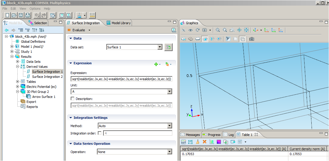

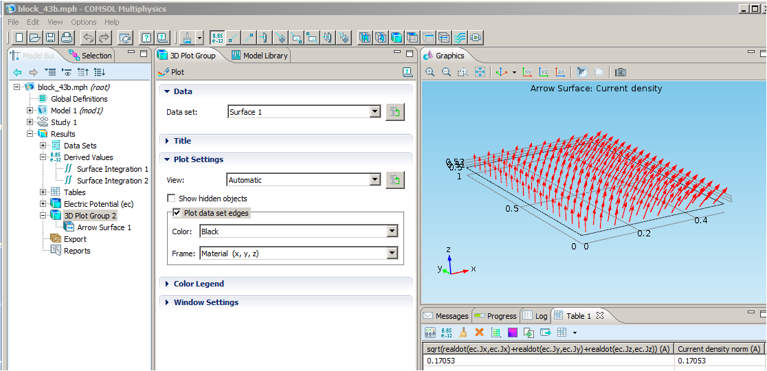

Something I can't understand. See the attached trivial model. In Surface Integration 1, if I select ec.nJ from the menu, I get an error message (same with trying to plot it or export it), but if I look up the definition of ec.nJ in Equation View of Current Conservation 1, and enter that expression, instead of ec.nJ, it works fine.
ec.nJ is defined as:
sqrt(realdot(ec.Jx,ec.Jx)+realdot(ec.Jy,ec.Jy)+realdot(ec.Jz,ec.Jz))
The error message I get is:
