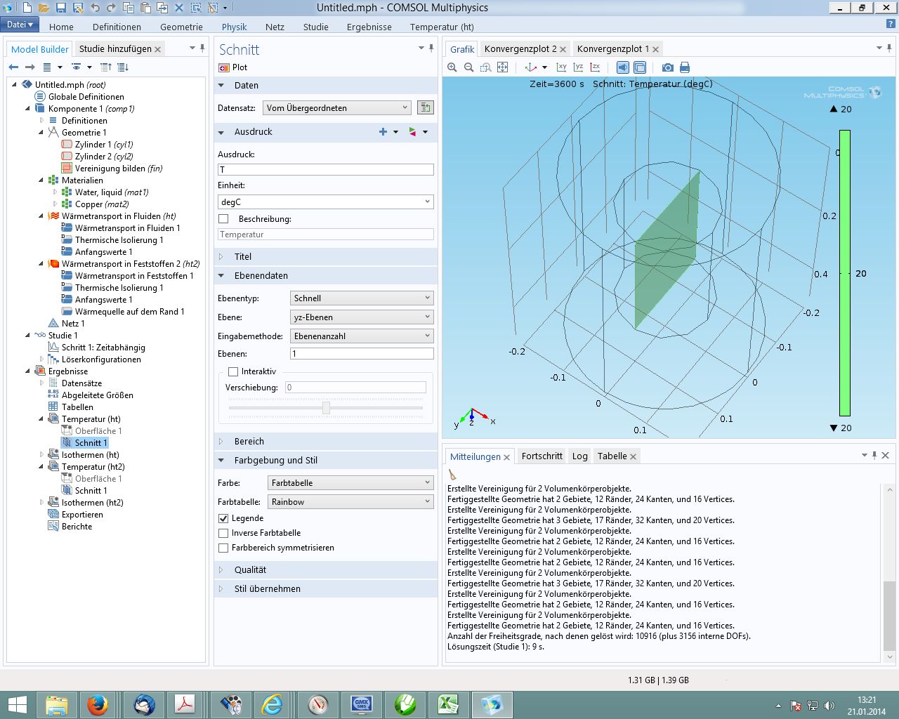

it is possible to thermally connect both physics modes. However, I think in this case the easiest way would be to use only one mode (e.g. Heat Transfer in Solids) for all domains (copper and water) and to add a Heat Transfer in Fluids Domain within the mode for the water domain. The advantage is that the temperature continuity is automatically realised and there is only one temperature variable.
If there are two temperature modes (e.g. ht1 and ht1), there are by default also two temperature variables T and T2. This might also be the reason for your result (twice the temperature (T) in the inner cylinder).

                                                    Thank You Philpp. Yes that works so far. Heat now is flowing between the two domains.
I also want to include thermal expansion resulting from the application of  a boundary heat source.
Therefore I added the "Structural Mechanics Module" and chose "Solid Mechanics" for the whole system consisting of copper and water. By an error message I was asked to add the physical data of water (Young's modulus, Poisson ratio and Coefficient of thermal expansion) manually. But probably I should not use te "Solid Mechanics" node for the water domain?? But what should I use for the water reacting to and transmitting heat and pressure?? Another COMSOL module?
In the end I get an error message:
Undefined value found.
	- Detail: Undefined value found in the stiffness matrix.
There are 1820 equations giving NaN/Inf in the matrix rows for the variable comp1.u.
 at coordinates: (-0.0866029,0.0499994,0.1), (-0.0500011,0.0866019,0.1), (-0.0707113,0.07071,0.1), (-0.1,0,0.1), (-0.0965927,0.0258816,0.1), ...
There are 1820 equations giving NaN/Inf in the matrix rows for the variable comp1.v.
There are 1820 equations giving NaN/Inf in the matrix rows for the variable comp1.w.
and similarly for the degrees of freedom, NaN/Inf in the matrix columns.

When there are two physics nodes using Temperature as a variable you can overwrite the “T2” in the second one with T. That way they use the same degrees of freedom. Also instead of using separate fluid and solid heat transfer physics consider using the “Conjugate Heat Transfer” which automatically handles both solid and fluid.

                                                    One more thought. If you do not expect the change in solid geometry due to thermal expansion to affect the flow I suggest solving the heat transfer problem first then setting up an structural analysis that uses the temperature from the first solution to calculate thermal expansion and thermal stresses.

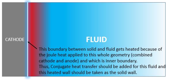

Thank you for your help. I am doing simulation for electrochemical cell joule heating. I have my electrodes and electrolyte in an 2D axysymmetric model. I take the joule heat and I am applying heat transfer as you have suggested. It works fine for me. However, within the combined geometry, I wanted to add convective heat transfer at the wall of electrode and electrolyte (within geometry) which is inaccessible being internal boundary. PFA image showing inaccessible boundary.  What kind of Physics do you recommend me to use?

thats right, you can not convective heat transfer to an "inner" boundary. Convective heat transfer boundary condition is meant to be used if you do not actually want to simulate the fluid outside where the convection takes place.
However, if you are modeling this outside part, there is no need to add the boundary condition because the convective heat flux is computed correctly.

I am grateful for your support. I am sorry I did not explain my problem properly. I am not simulating the outside part and I am giving convective heat transfer at those boundaries as you correctly said so.
Whereas I want to add conjugate heat transfer to the fluid inside my geometry where it comes in contact with the cathode (solid wall which is also part of my component). I want to add the conjugate heat transfer at the inner boundary of cathode and fluid and simulate that simultaneously with the overall conduction in component. (see attached image).
I have added separate 'conjugate heat transfer' but not sure how to couple them to run it simultaneously at each time step.
Also, temperature of fluid is going above the boiling point even if I add heat transfer with phase change.
