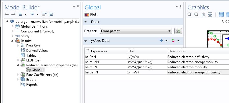

I want to input the mobility results of the Boltzman-2-term-model for Argon into a microwave plasma model.
But: the export format from the Boltzmann model is far from what the mwp model accepts as input (import) in the look-up table for the DeN or other mobility parameters..
My Comsol hangs for 20 minutes whenever I want to read in 300 pairs of values .. (after modifying the export file of the boltzman model)
Is there a limit for those imports for the mobility look-up tables?
Why is it so mendokusai? troublesome? (i am in v44)
thanks
lukas
Hello, I want to input the mobility results of the Boltzman-2-term-model for Argon into a microwave plasma model. But: the export format from the Boltzmann model is far from what the mwp model accepts as input (import) in the look-up table for the DeN or other mobility parameters.. My Comsol hangs for 20 minutes whenever I want to read in 300 pairs of values .. (after modifying the export file of the boltzman model) Is there a limit for those imports for the mobility look-up tables? Why is it so mendokusai? troublesome? (i am in v44) thanks lukas
Luke Gritter Certified Consultant
Posted: 1 decade ago 12 sept. 2014, 19:10 UTC+2
Lukas,
I'm not aware of a limit for the table size, though I have occasionally seen the software have difficulty loading multiple large tables. Three hundred pairs of values is probably somewhat excessive - you should be able to adequately describe the transport coefficients with much less than that.
If you are also loading rate coefficients from the COMSOL Boltzmann solver, beware of the units. Last I checked, the MWP interface expects rate coefficients in m^3/(mol*s) while the Boltzmann solver outputs rate coefficients in m^3/s, so be sure to do the conversion.

Posted: 1 decade ago 15 sept. 2014, 11:04 UTC+2
Dear Mr. Gritter
Thanks for that..
my PC was not healthy, that is why it could not import the data..
(registry clean and so on helped)
I hope I do not have to change anything for the mobilties/diffusivities? it is not clear where to look for that?
the exports are documented (see file)
I believe these are also the import units..
arigatou..
may you have a look in my model (model exchange) and tell me why it is possible for a mwp model to have DC-plasma densities above 10E17 [1/m^3] (study1 of MVP16-upload using 250V instead of the 200V set in the variables)
Dear Mr. Gritter Thanks for that.. my PC was not healthy, that is why it could not import the data.. (registry clean and so on helped) I hope I do not have to change anything for the mobilties/diffusivities? it is not clear where to look for that? the exports are documented (see file) I believe these are also the import units.. arigatou.. may you have a look in my model (model exchange) and tell me why it is possible for a mwp model to have DC-plasma densities above 10E17 [1/m^3] (study1 of MVP16-upload using 250V instead of the 200V set in the variables)
