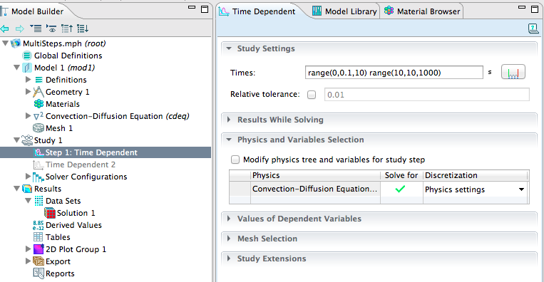

Posted: 1 decade ago 2 mars 2014, 15:36 UTC+1
Dear Martin,
you can perform it in 1 step using the syntax that you find in the screenshot.
Let me know if it works.
Regards
