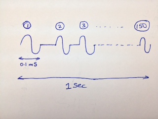

                                                    Dear,
I want to write an expression for sine wave which is time dependent. The parameters are the amplitude is 3, duration of the wave is 0.1 milliseconds and the frequency of waves is 150 Hz. I tried to write it as 3*sin(2*pi*150[1/s]*t), but this gives me 150 sine waves of 6.66 millisecond duration per second. But I want 150 sine waves per second with duration of 0.1 mSec with zero amplitude between the waves. Can you please help me. I did attached a jpeg file to show what I needed. I appreciate your support. Thank you.
