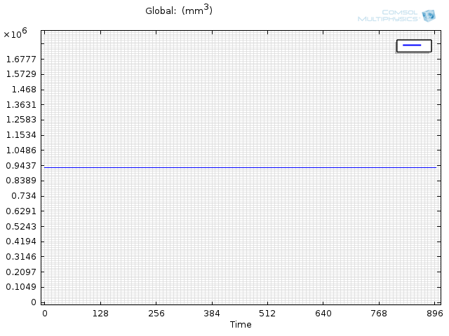

Under Definitions/Component Coupling/Integration, define operator “intop1” on the domain Geometric level. Then define variable
volume_iso=intop1(T>=50[degC])
to get the volume of tissue heated within an isothermal surface. You can plot variable “volume_iso” as a function of time.
Sergei
The graph I got has a constant volume with changing time even before the steady state condition but I expect the volume to increase with changing time.
To calculate this volume use to following expression:
intop1(T>=40[degC])-intop1(T>=50[degC])
Sergei
