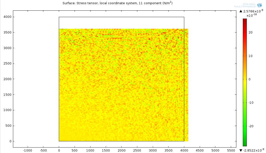

I have some fundamental problem with the solid mechanics problem. I have a square and would like to exert uniform load on the top surface. The simulated results give the correct y-stress (which is expected since this is y input), but the y-strain obtained is slightly smaller, which means that the modulus used is not the same as the material input young's modulus.
Hand calculated: y-stress:26250Pa ystrain: 8.47e-6 given E=3.1e9Pa
Comsol: y-stress: 26250Pa ystrain: 7.43e-6
Could it be that my boundary conditions are wrong and over-restricting the model. I have checked the Young's modulus after simulation and it is the same as the input value. Also, the strain in the x direction is wrong as I would expect it to be y-strain multiply by the poisson ratio, but it is not the case too. I have use a point fixed constraint at the bottom left point and also a "roller" for the bottom line.
Please advise. Thanks.
