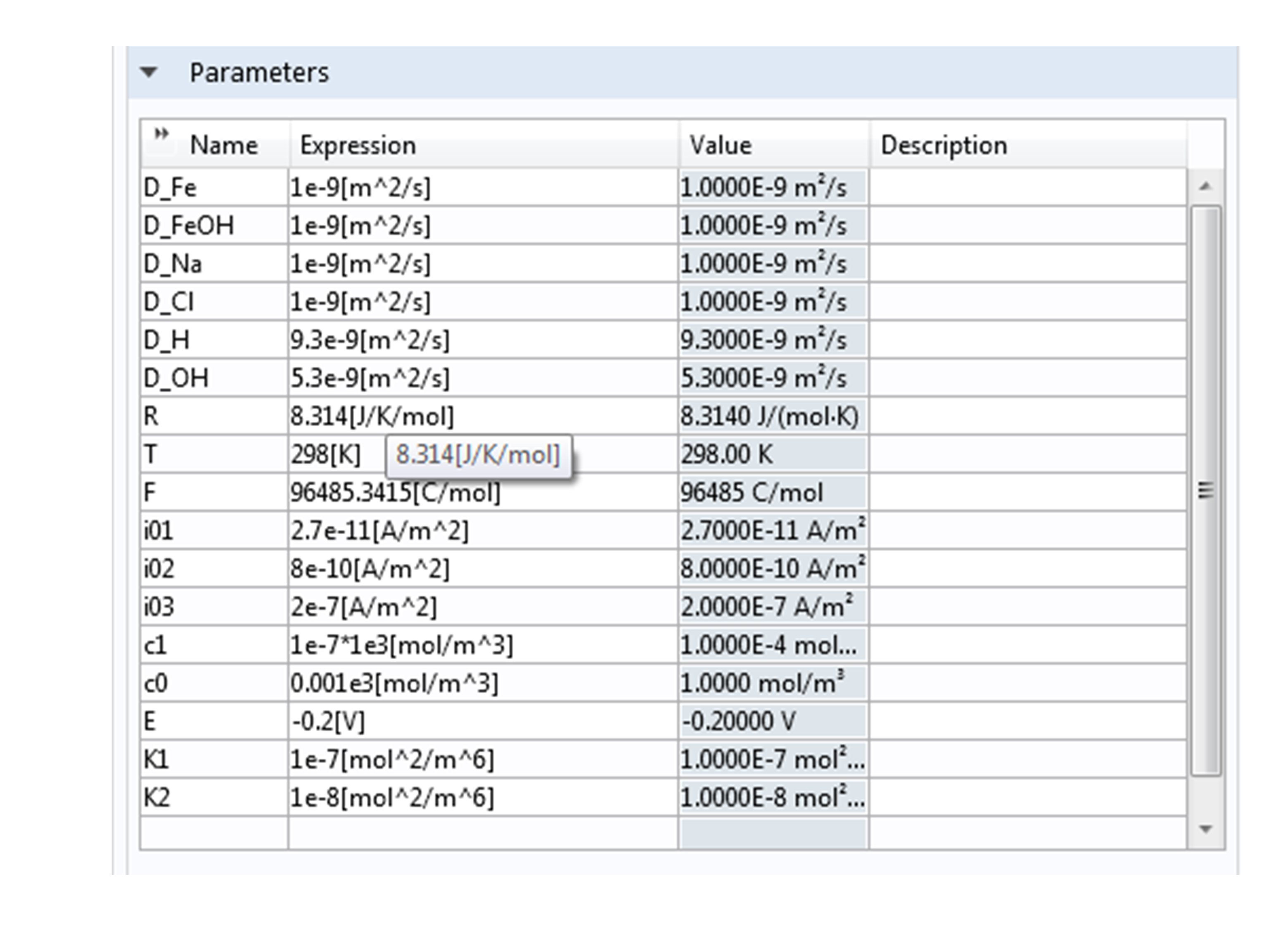

I am trying to simulate Sharland et al's paper with 6 species corrosion process. After long weeks of attempts I have used constraints to enforce equilibrium constraints.
Please find the attached model. It doesnt seem to generate any V(from electrostatics module) I tried to make mesh finer, doesnt converge.With a little coarser mesh , no V is captured.Face "undefined Value found' with a defined initial value for V.I have tried to replicate an existing model in 3.5a to 4.3a.

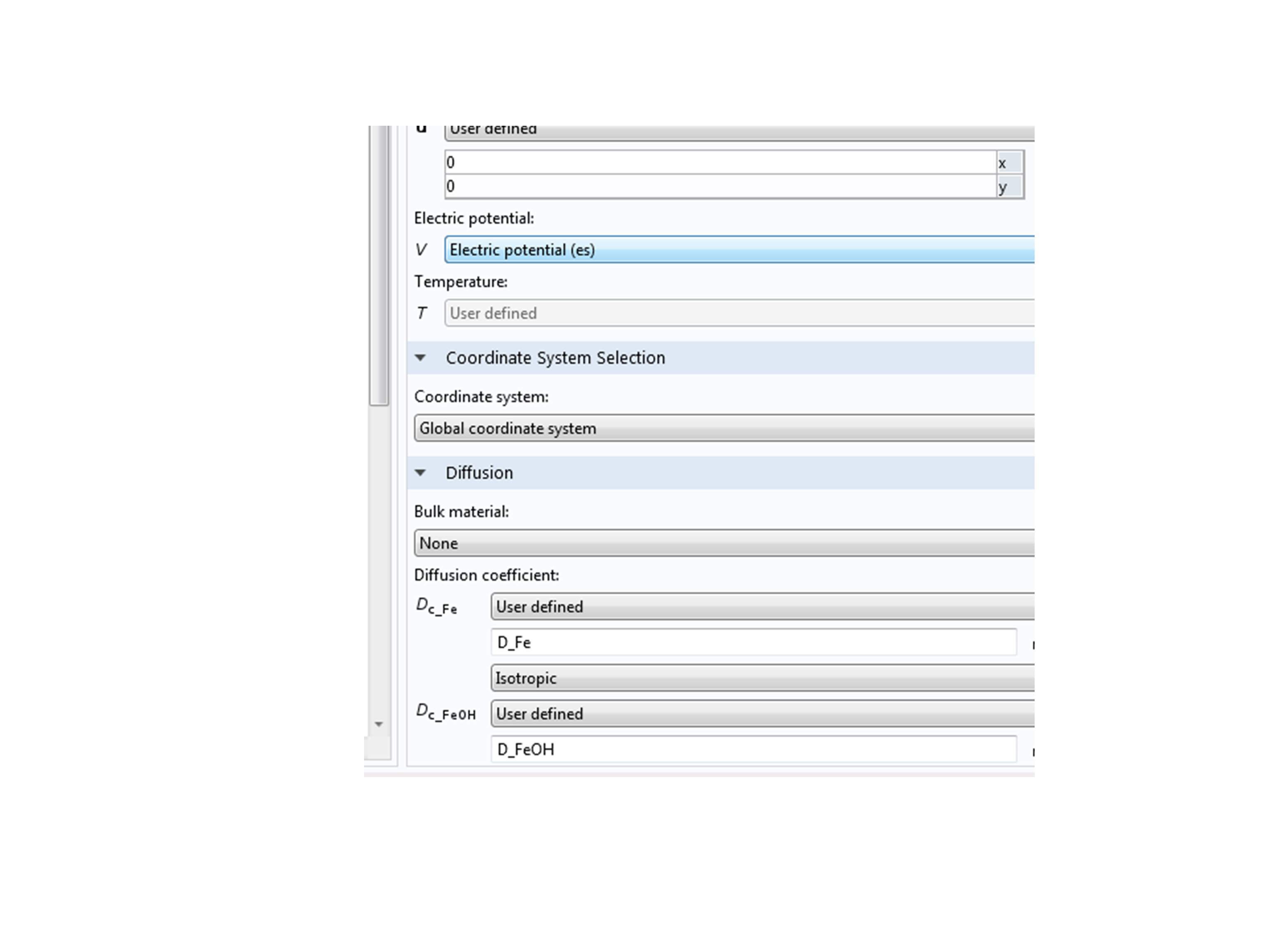

Your definition of the conductivity, k, had a small error. In the conductivity the charge numbers are raised to the second power, hence there are no negative terms in the summation.
In the node Transport of Diluted Species you have to couple the voltage variable V from the electrostatics node, see figure.
The solution converged, but I do not understad what you are simulating. Everything is constant in the solution plots. Why cannot you use Nernst-Planck equation instead of diffusion and electrostatics separately?
Wish this helps

I actually tried with units too. It doesn't work Then I retried by removing units to simulate exactly the one I have in converted 3.5a version.It is very weird when same thing doesnt work in newer version.
I have a 6 species corrosionproblem(Fe,FeOH,H,OH,Na,Cl).It has 3 heterogenous electrochemical equations(using bulter volmer relationship) to define flux of H, OH, Fe at crevice tip and a fixed concentration of all species on other end of the crevice(crevice mouth) to simulate bulk.
I am trying to define a charge density by electrostatics module that will effect the electric field(governing electrostatic potential) down the crevice.
The three flux equations represent Fe oxidation , water reduction producing OH species and hydrogen reduction.
To include homogenous equillibrium reactions Fe+H2O-->FeOH+H and water dissociation with equillibrium constants K1 and K2.I intend to work the mass transport problem that is constrained by equillibrium constant such that concentrations of all species satisfies the constraint at all times.
I am guessing it is do with mesh.I have tried running each module while defining a good initial value of 0.2 V but cracks up for second constraint of metal hydrolysis recation mentioned above.
I have attached my model with units too. I will play with the value of io1 as you suggested.I have also attached a paper that I am trying to reproduce.
