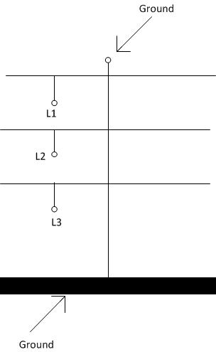

Dejan,
you can apply phase shift using complex notation. Ground or electric potential BC is available under the Magnetic Insulation node.
