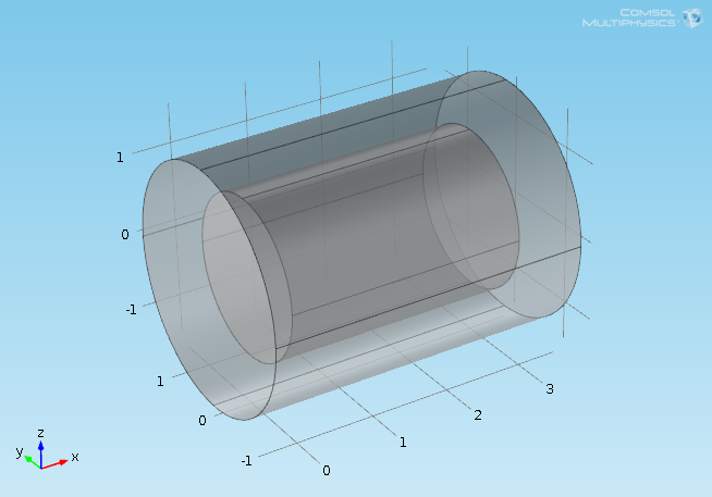

I need to create a hollow cylinder surrounding a separate cylinder. How do I do this?

I would have a Work plane, draw two rectangles and rotate the workplane. See attached.

Thank you for your help! I was unfamiliar with the revolve function and your advice allowed me to build my model.
