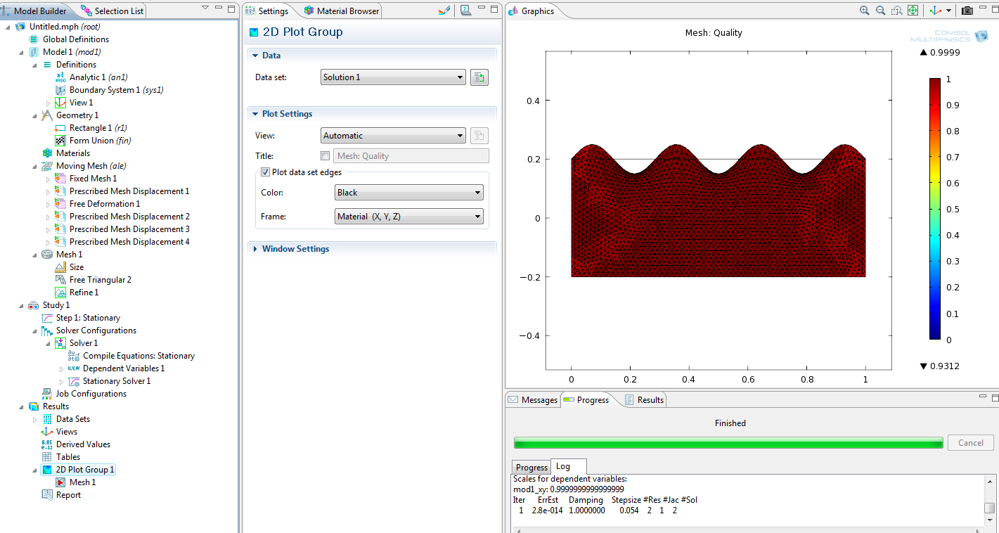

Posted: 1 decade ago 10 oct. 2010, 06:33 UTC−4
you are right in V4 "ale" is under "Mathematics - Deformed mesh"
Then by default V4 comes with Fixed Mesh "all" for the full/all volume so you must add:
Free Deformation and select domain 1 (the only one or the one you want to deform if several)
Thereafter you might define your boundary Prescribed mesh displacements
in V4 I ususally leave the two default entries Fixed Mesh 1 and Prescribed Mesh Displacement 1 as is and add my own thereafter.
For this example:
1x Free Displacement (on the domain) and
3x Prescribed Mesh Displacements on the Boundaries sa described.
The mesh "size" is in the "SIZE" subnode of the mesh, the first subnode is a global settings (or the one you add to a partial meshing command)
The mesh refinement is somewhat hidden in the sub-node: right-click_on_Mesh + More_Operations + Refine
Then solve, to see the mesh, use a mesh plot (right click under Results - 2D Plot Group)

Posted: 1 decade ago 10 oct. 2010, 16:42 UTC−4
Problem solved:) Thank you very much!
