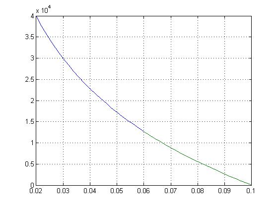

Analitically, I should have the potential as:
For the innermost part of the ring, the one that has a boundary with electric potential, the potential inside this domain is defined as:
V1(r) = V_boundary + (V_boundary - V_ground) * log(r / r_min) / log (r_min/ r_max )
For the outermost part of the ring, the one that has a boundary with ground set, the potential inside this domain is defined as:
V2(r) = V_ground + (V_boundary - V_ground) * log( r / r_max ) / log ( r_min / r_max )
Where V_boundary is the potential, V_ground is the ground, r is the radius of the point where I want to calculate the potential, r_min is the innermost part of the ring and r_max is the outermost part of the ring.
Plotting this for
1) V_boundary of 40.000 V,
2) r_min = 0.02 m,
3) r_max = 0.10 m
4) each domain having 0.04 m
(so 0.02 -> 0.06 m is domain 1, and 0.06 -> 0.10 m is domain 2)
5) sigma_domain1 = 1e-15 S/m
6) sigma_domain2 = 1e-16 S/m
7) epsilon_r_domain1 = 2.2 -
8) epsilon_r_domain2 = 3.5 -
I **should** have something like this:
-- Attached file : Image_analytical

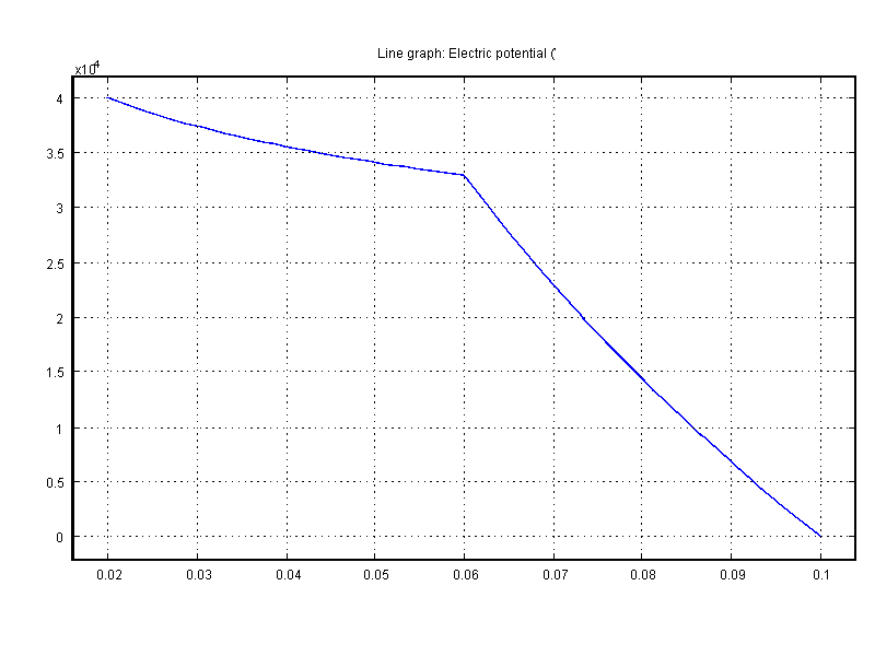

Using this model, or using its counterpoint axi-symmetric 2D model, I keep getting this result:
-- Attached file : Image_comsol
I've tried using Union mode and Assembly mode for creating the geometry, but alas, it's still the same. I've attached all 3 models which basically all give the same result, different than the one I should be getting analytically.
