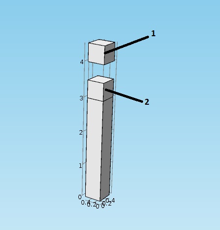

I want to create two magnets (Assume to blocks up and down with a distance from each other) that have opposite polarities so as a result they will repel each other. (see attached pic)
How can I do that?

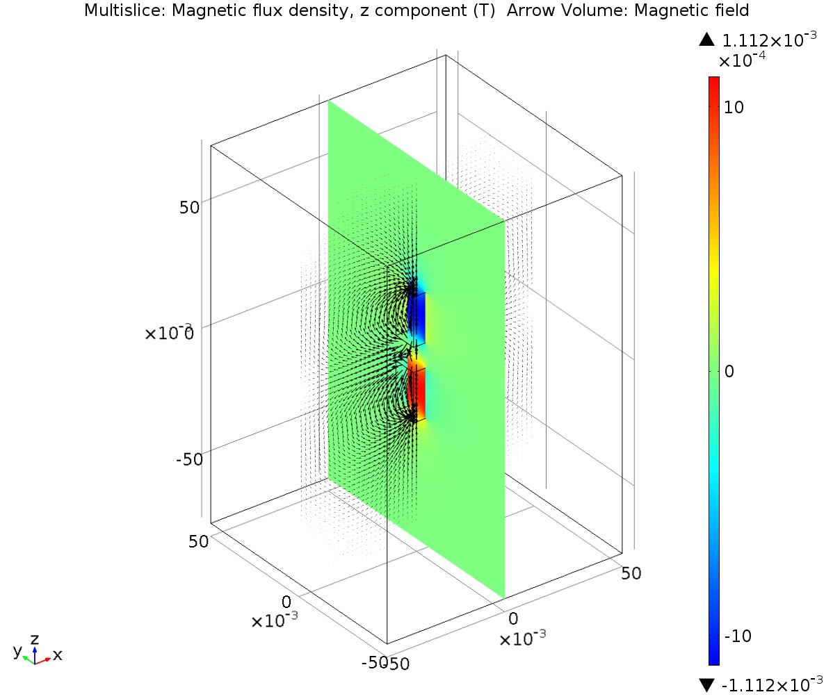

(1) you never defined your materials, and
(2) you did not include any volume of space around your magnets.
Both are essential before you can run your model. Every field region in the model requires material properties. And you must include plenty of space around your magnets, so that the fields can be computed within that space.
