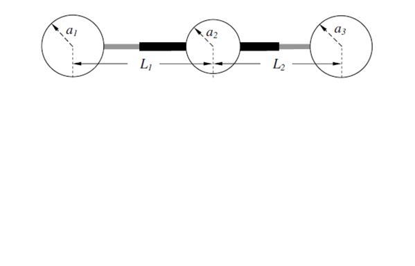

I'm new to comsol and I'm trying to model the flow of three spheres connected by two movable rods in a stationery fluid. There is relative motion between the spheres as the rods move to and fro.
I'm trying to analyze the motion of this sphere-rod system in the fluid.
How do I make the fluid stationery while the rods move? Do I model the rods as walls with slip condition? If I do that, how do I make the sphere move along with the corresponding rod?
