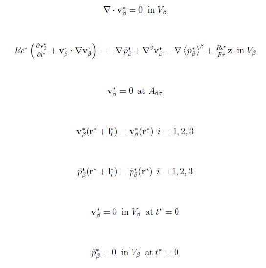

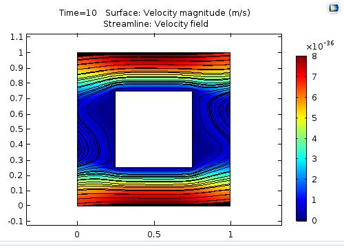

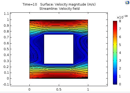

Dear Erik,
Thank you for your reply.
The problems I have met are as follows.
1) Using PDE equations, if I adopted the stationary solutions as the initial values for the time-dependent sovler, the obtained transient results will just the same as the steady ones, even for a very large Re number;
2) I have tried the built-in laminary flow interface. But the results strongly depend on the initial values as shown in the attachment (the initial value for u is 1e-2, 1e-20 separately at Re=10); since I run a large range for Re and the geometry is quite complex, which make it impossible to calculate the initial values at the corresponding Re.
3) As for the "flow past a cylinder" model, it defines a "step1" to trigger the disturbance at the inlet boundary; while I used the periodic boundary conditions, thus the only place to use "step1" is at the initial values setting windows, which will mix the problem (2) about determining the initial values.

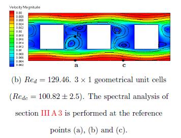

Posted: 9 years ago 1 déc. 2016, 03:22 UTC−5
Dear Erik,
Thank you.
I have tried to contact the support, but since I used the PDEs, it is quite difficult for them to find a solution. I am trying to solve the Navier-Stokes equations with the built-in laminary solver instead of using the PDE equations.
I have run the case and the results from the transient solutions seem to be that obtained with a steady solution.
The expected result can be seen in the reference(attachment).
Is there something wrong about my settings? or should I add a perturbation to induce the unsteady flow, as in www.cfd-online.com/Forums/main/135769-time-dependent-solver-unsteady-navier-stokes.html
Would you please have a check?
Hope to hear from you soon.
Thank you.
Best Regards,
Bill
