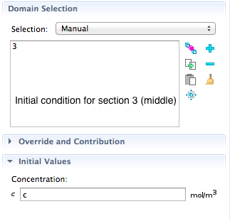

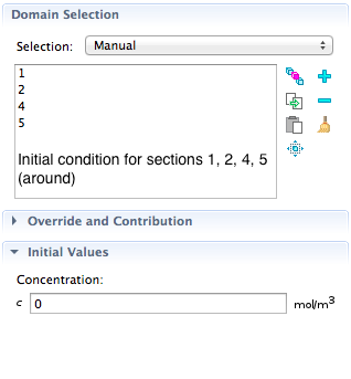

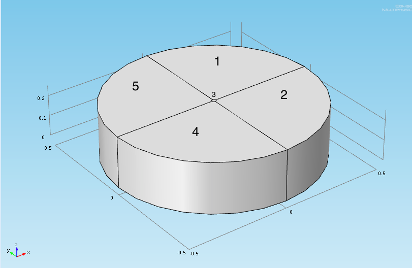

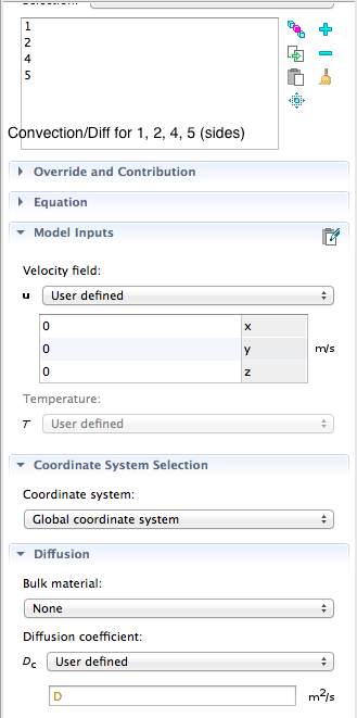

Here are some screenshots of my model -- maybe it'll be easier to see my error if you look at them? I have labeled what each screenshot is as text on the picture itself.
After running this model with a normal mesh, I still get the following error:
Failed to evaluate variable Jacobian.
- Variable: D
- Geometry: 1
- Domain: 1 2 4 5
Here are some screenshots of my model -- maybe it'll be easier to see my error if you look at them? I have labeled what each screenshot is as text on the picture itself. After running this model with a normal mesh, I still get the following error: Failed to evaluate variable Jacobian. - Variable: D - Geometry: 1 - Domain: 1 2 4 5

I think you need to extend the bigger cylinder in the positive and negative z-direction because the nonanal can also diffuse in that direction.
Also, there will be no diffusion inside the arm itself right?
You have not defined D and c. You can define them by adding a 'parameters' node to 'global definitions', and putting them their with the number that belongs to them.
I think you need to extend the bigger cylinder in the positive and negative z-direction because the nonanal can also diffuse in that direction. Also, there will be no diffusion inside the arm itself right? You have not defined D and c. You can define them by adding a 'parameters' node to 'global definitions', and putting them their with the number that belongs to them.
