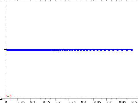

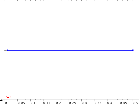

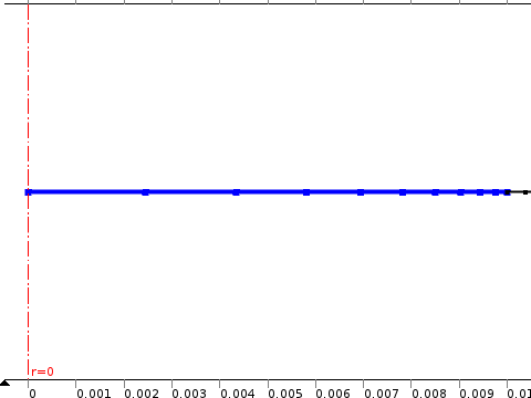

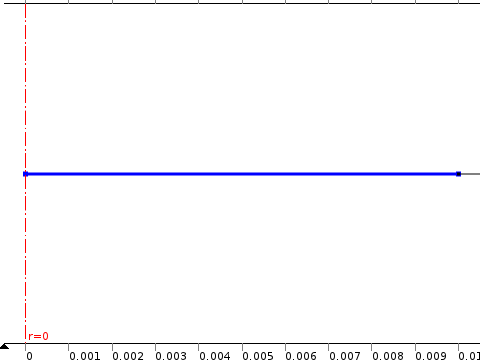

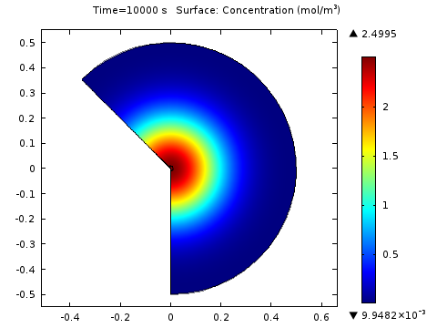

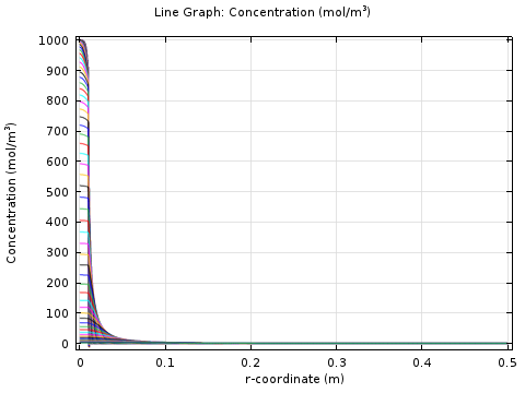

Posted: 1 decade ago 7 août 2014, 12:16 UTC+2
You have to define an explicit value for the initial concentration. It can be also time-dependent, but it cannot be a free variable.

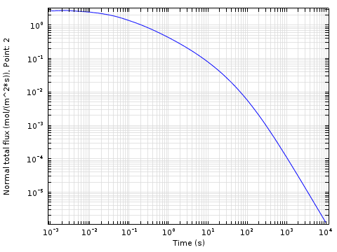

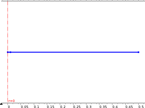

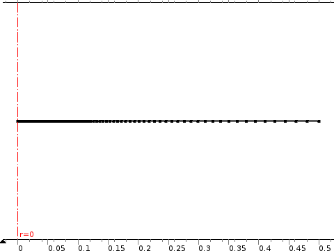

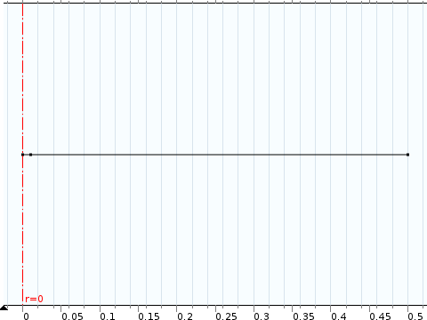

Your geometry is such that a 3D model is not needed. I made an axisymmetric 1D model for you, attached. I use version 4.4, I wish you can open it.
Also some figures from the model report are attached.
BR
Lasse
You have to define an explicit value for the initial concentration. It can be also time-dependent, but it cannot be a free variable. Your geometry is such that a 3D model is not needed. I made an axisymmetric 1D model for you, attached. I use version 4.4, I wish you can open it. Also some figures from the model report are attached. BR Lasse
