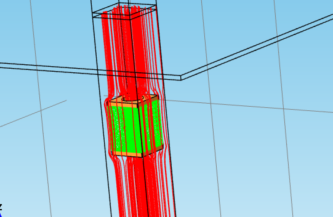

ok getting there (see screenshot). But I cannot superimpose with streamlines. When I click on streamline the colours disappear and it goes back to transparent.
Just another general question. This method is a kind of workaround, there is then no way to use the colours I assigned to the materials for the solutions. Is there a way to actually display the material with its assigned colours even without superimposing the solutions. In other words what is the use of having material colours?
Thanks,
Sebastien
Hi, ok getting there (see screenshot). But I cannot superimpose with streamlines. When I click on streamline the colours disappear and it goes back to transparent. Just another general question. This method is a kind of workaround, there is then no way to use the colours I assigned to the materials for the solutions. Is there a way to actually display the material with its assigned colours even without superimposing the solutions. In other words what is the use of having material colours? Thanks, Sebastien
Posted: 1 decade ago 14 août 2014, 10:20 UTC+2
This is the only method i know. Hopefully someone will show us another one.
Plot both the streamlines and the surface plot under the same 3D plot group. Probably it will solve the problem.

Posted: 1 decade ago 14 août 2014, 10:35 UTC+2
yes ok thanks very much for you help this works.
But yes this is fine if you only have two objects to select but off course becomes impossible when the model will be more complicate. If someone knows a way to do this by simply using the assigned material colours it would be great (I mean there should be a way, otherwise what is the point in having material colours?).
