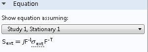

Dear Kjelberg,
Right now I'm working only on the bridge with magnet. I have a problem with external stress and pre-stress frequency domain analysis. For the external stress in the linear elastic material, the equation of external stress is not consistent. Also, if I use Sext = sigma(ext), it won't have any changes to the study. However, if I use the Sext = JF^-1 sigma(ext) F^-T, it works for eigenfrequecny and stationary study. I have two questions for you. Firstly, why Sext = sigma(ext) doesn't work. Secondly, How can I apply external stress to frequency domain study? The pre-stress study doesn't work. I change everything include adding harmonic load, phase....
Thanks in advance,
