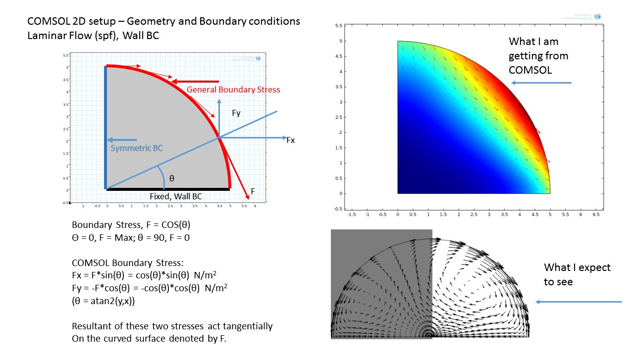

Here is the problem setup in 2D:
A semi circular surface. Straight edge is fixed. Circular curved surface has shear stress applied on it (Marangoni effect). Center of the curved surface has 0 shear stress, it goes to a maximum near the edge where it meets the straight surface. So I am modeling half of the semicircle with a symmetry boundary condition. Please see the figure attached.
With these stresses applied, I should observe a double circular flow as shown in figure. But instead I am getting something else. I have used "boundary stress" and "general stress". Did I do anything wrong? Is there a way to apply u.n=0 on the curved boundary surface and also apply the stress?

Hi there,
The plot that shows what you expect to see does not display symmetry about the vertical axis. Under those circumstances, it should not be surprising that you get a different result in a COMSOL model that presumes symmetry.

Posted: 1 decade ago 19 sept. 2014, 23:18 UTC+2
Thanks Jeff. The attached plot is from the actual system, that's why it is little off from symmetry. But, I was the COMSOL solution should show symmetry. But what I am wondering is, why it is completely off, and not showing any circular flow at all.
Any suggestions as to how to implement u.n=0 on the curved boundary surface will be very helpful.
