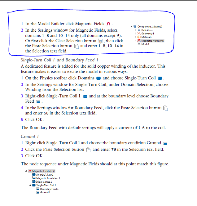

Nirmal Paudel COMSOL Employee
Posted: 10 years ago 8 déc. 2015, 08:58 UTC−5
Dear Jagadish,
The issue is most likely that you have the "Magnetic Fields" physics being solved in "all domains". You would first need to solve the "Magnetic Fields" only in domains "1-8 and 10-14". That is, you would have to remove Domain 9 from the "Magnetic Fields" physics to get access to these two Boundaries; "Boundary Feed" on 58 and "Ground" on 79.

Posted: 10 years ago 8 déc. 2015, 09:31 UTC−5
Thanks NIrmal. But this did not help.
Also the reference pdf for this application does not speak of this step at all.
I am working with the local AE to have this fixed. Will update when we have a resolution.
Thanks NIrmal. But this did not help. Also the reference pdf for this application does not speak of this step at all. I am working with the local AE to have this fixed. Will update when we have a resolution.
Kristian Rye Jensen COMSOL Employee
Posted: 10 years ago 11 févr. 2016, 12:05 UTC−5
I had a support case where someone experienced the same problem and refered to the discussion forum. That more people were experiencing this problem.
I've tried to go through the step-by-step one more time. If you don't disclude domain 9, which is written on page 26 on the top. I have attached the image, then you'll receive the Non-applicable for the boundary 58 and 79.
Furthermore I have attached the model until page 27, so you can continue from here.
Hope this helps.
