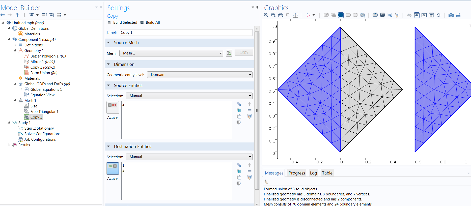

Posted: 1 decade ago 2 nov. 2015, 13:54 UTC−5
Normally if your part is symmetric the "copy mesh" will automatically detect this and make a symmetric copy hence you get your mirror operation, but I'm not sure if it's capable of a central symmetric mesh operation.
Try it out with a "sand case/toy-model"
Hi Normally if your part is symmetric the "copy mesh" will automatically detect this and make a symmetric copy hence you get your mirror operation, but I'm not sure if it's capable of a central symmetric mesh operation. Try it out with a "sand case/toy-model" -- Good luck Ivar
