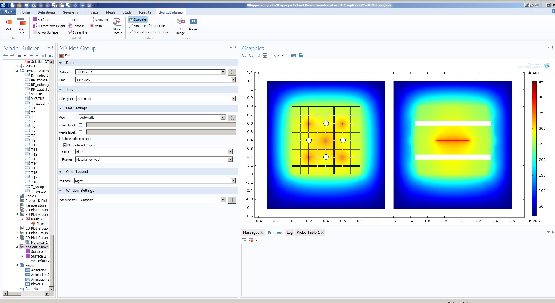

                                                    Hello, can anyone help me with creating animation with two perpendicular cut planes in 2D side by side?
I can do it like this, but I get data edges only for the first cut plane.
I define two Cut planes (in Results > data sets).
Then I define 2D plot group with data source Cut plane 1.
First surface has data from its parent (it is not possible to create animation without this)/
For the second surface i define data source Cut plane 2 and deformation funcion only with X values which defines the shift.
Now I get data edges only for Cut plane 1. Is there any way to get the data edges also for shifted Cut plane 2?
Bottom line: It is nice, that COMSOL added possibility for creating animations like this. I think, that in previous version, the only surface with data from 2D plot group was animated and the second was still.
