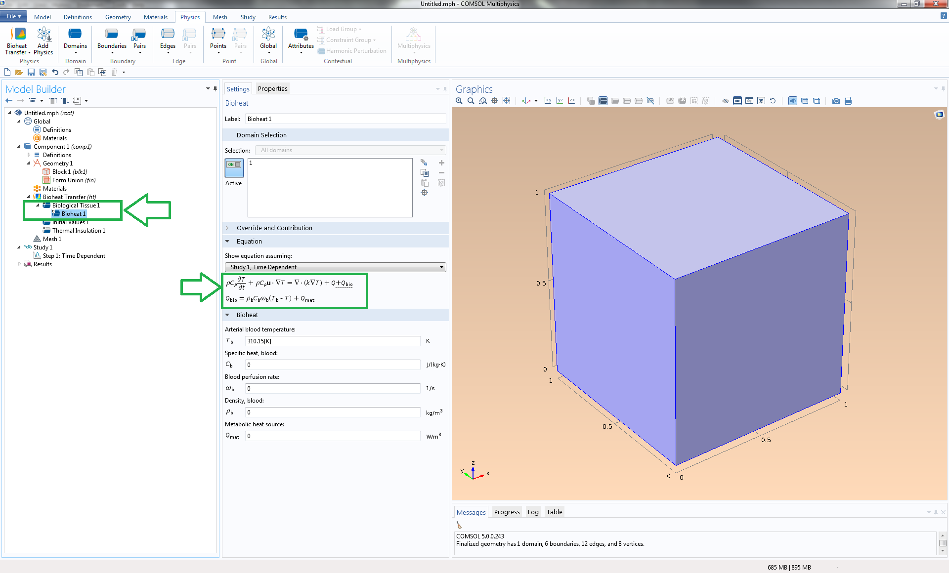

Pennes equation is implemented in the Heat Transfer Module, see attached screenshot.
To determine if your license includes the HEat Transfer Module, go to File>Licensed and Used Products.
Hello, Pennes equation is implemented in the Heat Transfer Module, see attached screenshot. To determine if your license includes the HEat Transfer Module, go to File>Licensed and Used Products. Best, Jeff
