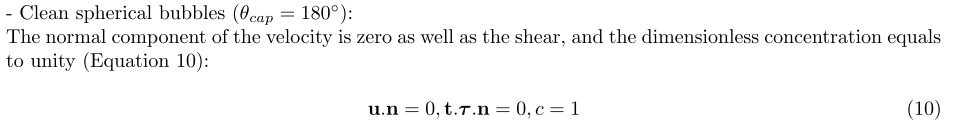

I use the PDE and 2D axisymmetric model module to simulate. when setting the boundary condition of zero shear stress at bubble surface, I encounter a problem that the boundary condition is "t.T.n=0"as shown in the image.
I wonder if someone knows how to transform this condition so that it can be used in comsol.
