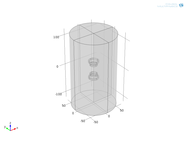

I've made a model of a static permanent magnets system, using AC/DC Module Magnetic Fields, No currents Physics.
The image of the geometry is attached to this post.
I'm calculating electromagnetic force that acts on the inside pair of magnetic rings. The magnets are magnetized axially.

However, I've made a 3D model with the very same geometry and physics settings. When I use the radial displacement dR both in model geometry and DG I get different results using parametric sweep (2 times greater) than in the single step simulation for a certain value of dR without using DG. In my particular case, the function Fr(dR) is close to linear, so it looks like the distance is taken into account twice and therefore I get 2 times greater results.
On the other hand the magnetic flux density graph in the crossection plane zx (y=0) looks as if the dR is only accounted for once.
I tried refining the mesh, but the effect persists.
Could you please tell me what can be the case here? Do you have any idea why I do get different results? Should I take the displacement dR into account both in the geometry and DG in 3D? And if not, why is it different than in 2D axial?
