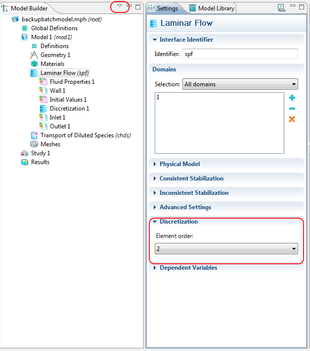

Hello Davis,
to the right of the Model Builder tab, there is a "View" menu button. It has a small upside-down white triangle on it. There, select "Show more options". Then go to the physics node, for example, Laminar Flow. In the settings windows, you find the Discretization area and Element order. See attached screenshot dicretization.png. I highlighted with red the areas of interest.
We added the "Show more options" feature to make the interface cleaner.
Niklas Rom, COMSOL

Hello Davis, to the right of the Model Builder tab, there is a "View" menu button. It has a small upside-down white triangle on it. There, select "Show more options". Then go to the physics node, for example, Laminar Flow. In the settings windows, you find the Discretization area and Element order. See attached screenshot dicretization.png. I highlighted with red the areas of interest. We added the "Show more options" feature to make the interface cleaner. Niklas Rom, COMSOL [QUOTE] Ivar, nope, nothing under the mesh tabs. Mystery remains unsolved, but I'm still looking. If anyone else can point me to the information it would be much appreciated. Thx. (It was easy under 3.5a.) [/QUOTE]

Hi Niklas,
Got it! Thanks!
This selects the element order of the default assigned type. How does one select among various element types, or shape functions (shlag, shdisc, shbub, etc.)?

Dear Dave, unfortunately it is currently not possible to modify the default element type in any of the physics interfaces in 4.0. All you can do is change the order of the shape functions in the Discretization combobox.
It is also not currently possible to modify the integration order. It is fixed at twice the order of the shape function. Support for non-Lagrange shape functions in the mathematical interfaces will be added soon.
There is a rather painful work-around you can use today. You can add a weak contribution to your PDE and then add an auxiliary dependent variable. This auxiliary dependent variable allows you to select from Lagrange or discontinuous shape functions and also change the integration order. You have to deselect the degrees of freedom from the original PDE when solving so that only the auxiliary variables are solved for. This is done in the variables node under study (see the attached model).
