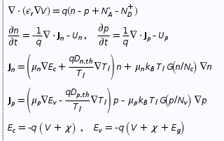

I would like to understand the terms in the equations that I attached.
What is Dn,th and how it is related to Dn?
What is the function G(n/Nc)?
thanks a lot,

See the theory section in the Semiconductor Module User's Guide, version 5.0, Chapter 3.
See the theory section in the Semiconductor Module User's Guide, version 5.0, Chapter 3. Jeff
