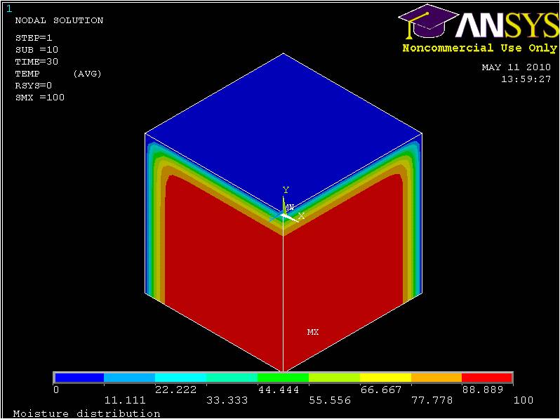

I did the same exact analysis in ANSYS and got the result as expected (temperature distribution within 0 to 100) I have attached the result.

I am checking concentrations to the order of 4 decimal, hence any little jump as observed in the solution is not acceptable.
