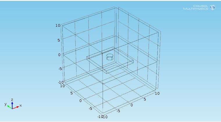

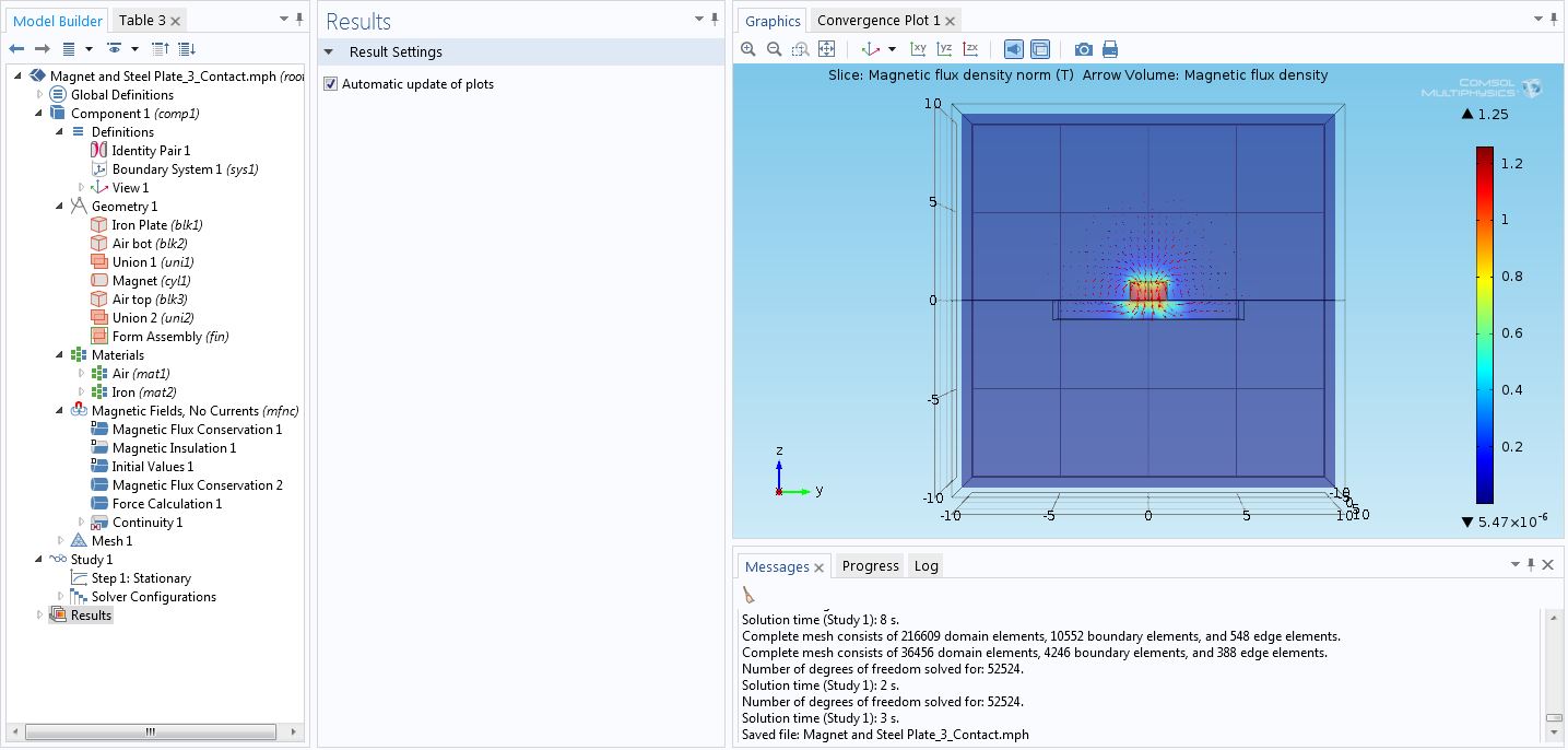

I am modeling a magnet attached to an iron plate in COMSOL. Enclosed is the picture of this simple model. I used two air boxes: one in top which includes the magnet and one in bottom which includes the plate. I used "Union 1" and "Union 2" to unite these air boxes with magnet and iron plate parts. Then used the "Form Assembly" command to simulate contact surfaces between these units. As the figure shows, it seems that the COMSOL calculates the flux density well. But, the problem is that COMSOL gives a very small value, almost close to zero, for the magnetic force applied on the Iron plate. This does not make sense. Because in another model, when I put the magnet close to the plate with a 1 mm gap, I get a force close to 160 N. So, it seems that the force in the first case, when they are in touch, should be some thing close to 200 N; however, I am not sure!
I would be thankful if someone help me to figure out where is my mistake in my FE model.
